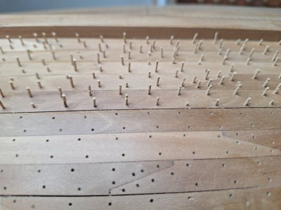

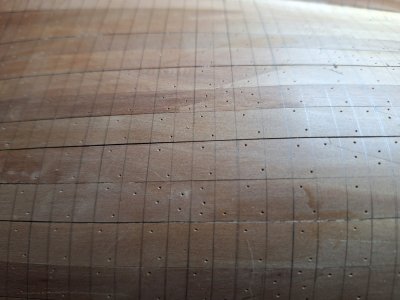

Hi to you all. First of all I want to express my gratitude for all of your visits and likes, much appreciated.
I have started nailing the hull. First of all i have drawn vertical lines on the hull as representation of the frames. That completed i used an awl to pinpoint where the nails would come.
I then drilled the holes and started inserting my earlier fabricated nails.

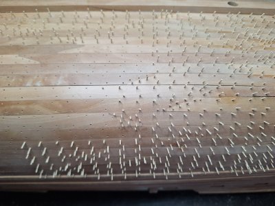

The holes drilled are just wide enough to press the nails in. One thing is certain, they will not fall out.
I have now completed about 2/3 of the port side -under the wales only- and am not certain I have fabricated enough nails (about 9000). Some were used to experiment, some are rejected or break pressing them into the hull and my estimate was probably off. The joints also require more nails. So I might have to produce more nails.
As you might have noticed in the pictures the pear wood has shrunk a bit due to drought. It has been very dry here the last few weeks and my shipyard is directly under the roof which makes it quite warm. To increase the humidity a bit there are now some water tanks and every evening I hang a soaking wet t-shirt over my chair. Let's see how far that will suffice.
