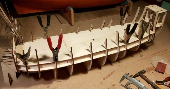

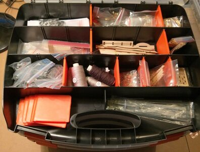

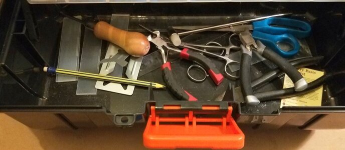

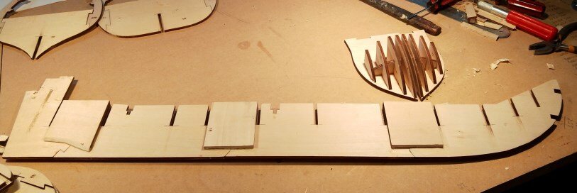

I bought this kit off of Face book market place for AUD $500, it came with the 135 magazines and the hull built to the stage shown in the pic below,

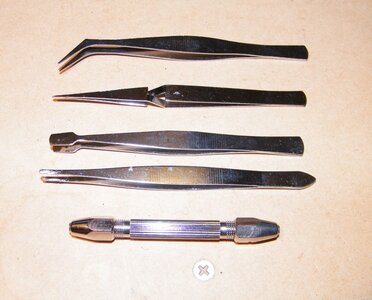

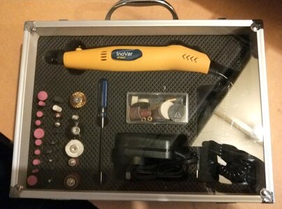

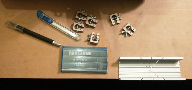

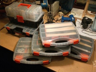

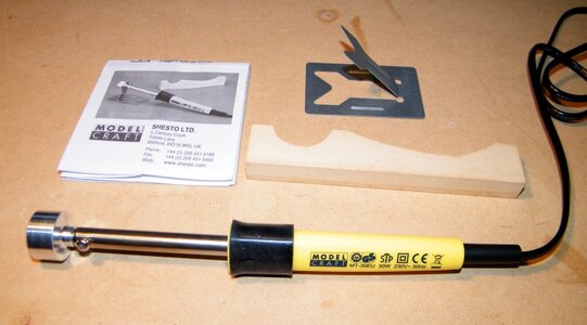

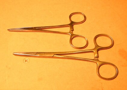

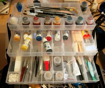

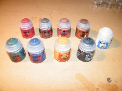

it also it came with all the following items, all brand new,

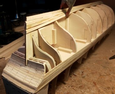

I haven't been feeling too good lately so I thought that for something non exertive I would take a look at the hull and how it had been built,
this is just going to be an out of the box build, no frills, with maybe just a couple of modifications along the way,

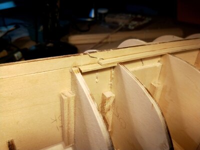

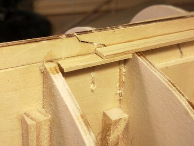

This is the hull as the previous owner had built it,

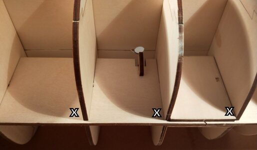

on closer inspection several of the bulkheads were not seated properly on the central keel, you can see where the XXX are,
also the deck sheeting panels were loose, and you can see in the above pic that there are only a few nails holding them,

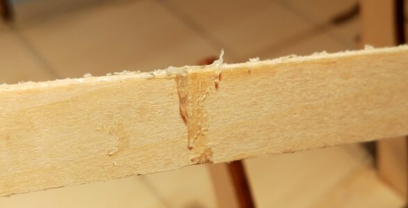

also the glue he had used was like a rubber cement, see in the above pic,
so i decided it had all to come apart and I would start from the begining, this is where the rubber cement worked
in my favour, and the decks just lifted off and the cement was easily cut with a sharp craft knife, thats the top deck
taken off with no breakages,

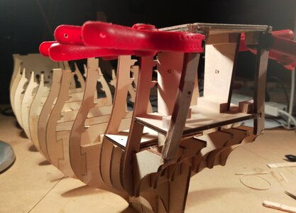

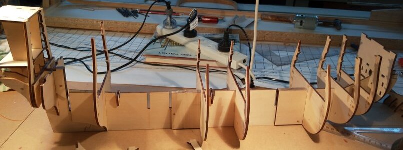

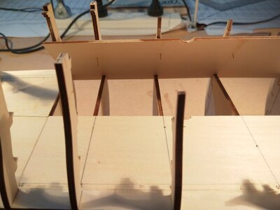

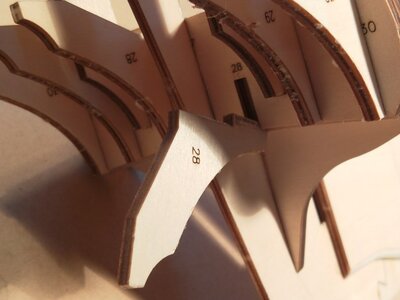

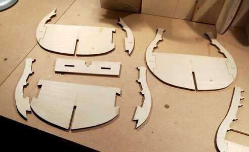

once I had removed the lower deck there was another shock awaiting me, a lot of the side framing parts had not
even been glued in place they were just sitting in place and the bulkheads themselves were not glued, they had
just been slid down over the central keel,
all the bulkheads just lifted up off the central keel,
it was the same at the stern, all the parts just pulled out,
in the end everything came apart cleanly, the only parts that were solidly glued were central keel reinforcing plates
and the bow section, so he must have used PVA glue on them,

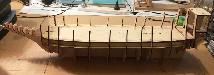

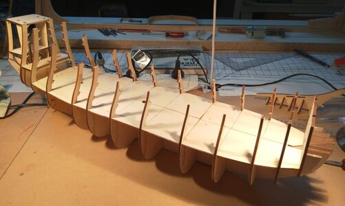

So after cleaning all the rubber cement glue off the parts I started reassembling the hull frame work,
Got all the bulkheads attached and working on the transom framing,

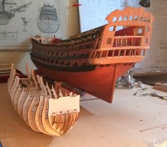

here she is sitting along side my Royal William, big difference the Royal William is 1/48 scale and the SOTS is 1/84,

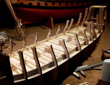

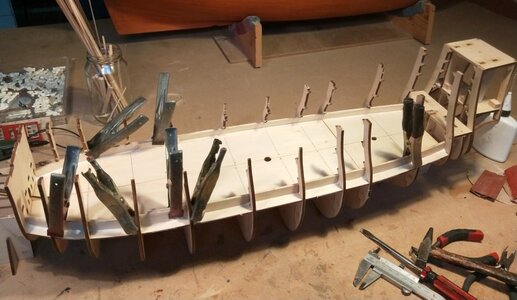

reattaching the cannon supports,
setting everything up for the next deck, I added small blocks under the deck timbers for extra security,
and here she is back to where she was when I bought her, but this time the glue used was Selleys quick set PVA,

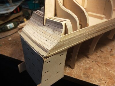

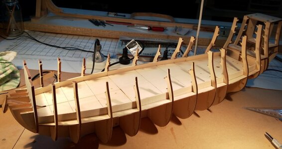

So thats the hull sanded and ready for planking, I don't like planking the hull and then adding the keel, the Stem
and the stern post, I prefer to add all of these then commence the planking, you can see the keel pieces and the stem
to the left of the pic,

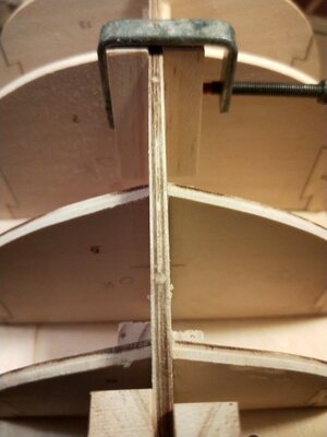

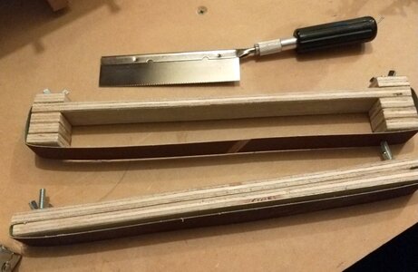

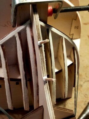

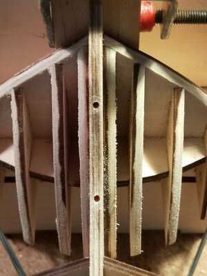

I drilled the stem piece to take the wood dowells I had prepared, I clamped it between
two blocks of wood to make sure it was in the correct place,
after gluing and dowelling the stem,
another pic of how I held the stem whilst drilling and dowelling,

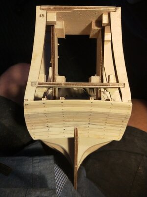

Next up was to plank the lower transoms, I planked these with the Bamboo supplied,
and every thing went well,

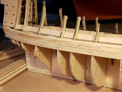

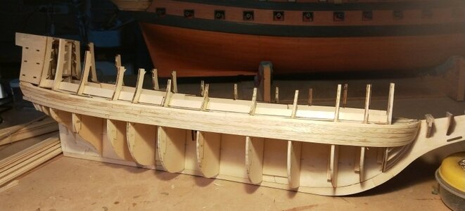

Then I attached five rows of planks to each side, the very top plank is the bamboo supplied and the four lower
ones are bass wood, i decided to use the Bass wood as some of the bamboo planks were splitting,
close up of the bow,
and a close up of the stern,
