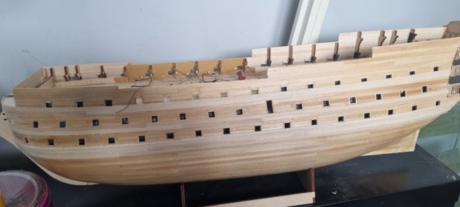

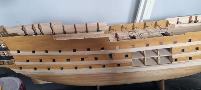

Good afternoon Andy. It is a huge task planking the HMS victory and it is looking good. The cut out is that part of the kit or are you getting adventurous :D. Either way it will make for interesting viewing. Cheers Grant
Hi Grant
Yes the cut out is an optional part of the kit definitely not adventurous
Andy
Hello everyone I am sorry that I haven't been on line for a while but Victory has been progressing though very slowly

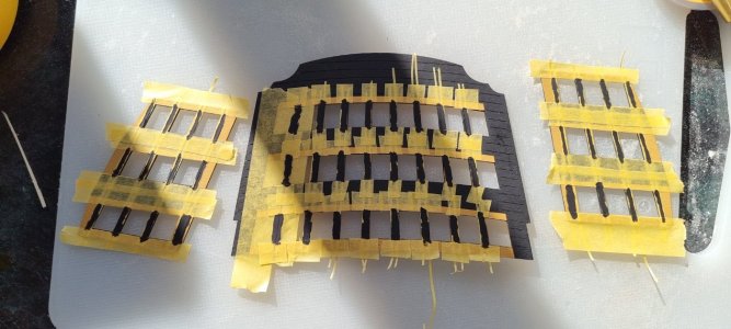

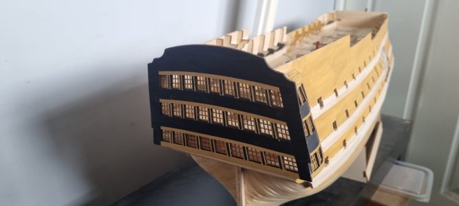

The planking is now completed and the whales fitted.All went quite well and I am reasonably satisfied. The stern galleries were next to be fitted using the parts from woodysmodelworks.co.uk

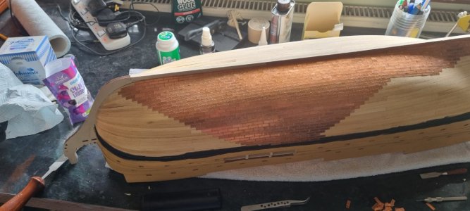

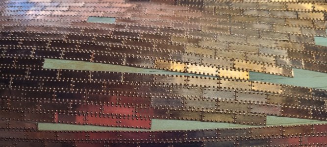

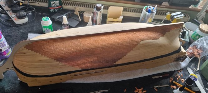

I am now starting to cover the hull in copper tiles... ever wish you hadn't started something????
A question for the more experienced.. do I cut the tiles to a point ? Or do I cut to a square and let them into the other tiles ?
As usual any comments or criticism would be great
Andy

It starts off similar to most POB kits the only difference from other kits is that the frames are not glued until the deck is fitted.This means that all the bulkheads are loose and can be fitted into the deck slots and then glued
This is not something I have seen before but looks to be a good way to build.The hull is then planked in the usual way.
