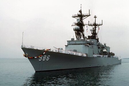

So next question. So my first hull number is 986, each digit has a 'hole in it, also these are all 1/700 scale so; should I try to match Modern Navy Hazy gray with printer or should try to cut it out of the center.

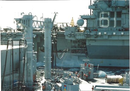

By the way the first picture is us returning to San Diego, in July '91. The second picture is the Ranger and us refueling from the USS Kansas City, Jan 15th 1991. Last UNREP prior to transiting the Straights of Hormuz on Jan 16th. And the Air War started at 3AM Jan 17th local time.

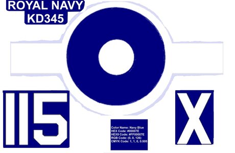

I had a similar problem with British Navy rondels for a Corsair 4FU. I created a light grey background on the edge of the rondel as a cut line. For the outer blue circle of the rondel, I simply left it coloured using the colour elements found on the Internet. I bought the inkjet paper from Amazon, that's also available in matt finish -
Self Adhesive Photo Paper Glossy - Uinkit 100 Sheets Sticky Inkjet Paper 8.5x11 6.5Mil 130G for Inkjet Printing Only​
Voila
