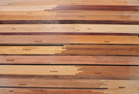

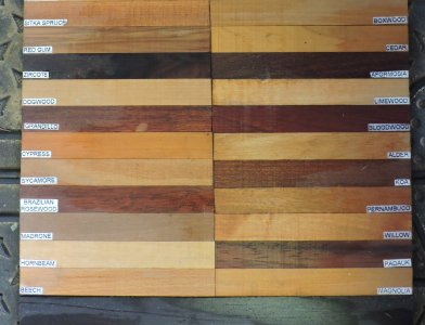

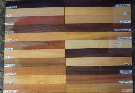

Hello all-
Building Winchelsea..cherry version.. I would like to plank deck in one of the following, ..swiss pear, boxwood, spruce, basswood ,holly..cherry is supplied.. My other builds use Bass..would like something different, but not over the top. Bulwarks will be red. Tung or satin poly for deck.. any preferences? Thanks in advance.

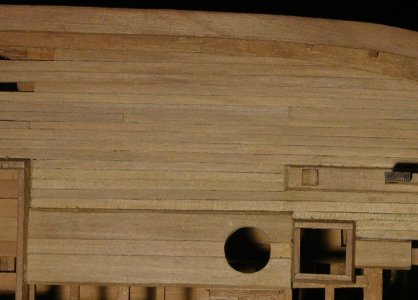

I've started using yellow cedar, it has a tight linear grain so it emulates a plank very nicely. Similar colour to castelo boxwood.20231205_213136.jpg
