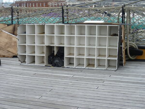

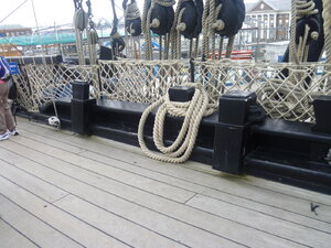

when I did my deck planks I think I cut them at 80mm as per the mamoli plans then fitted them brick pattern. When i visited the Victory to get some reference photos I realised my mistake..
but who is ever going to see my model who knows the truth?
