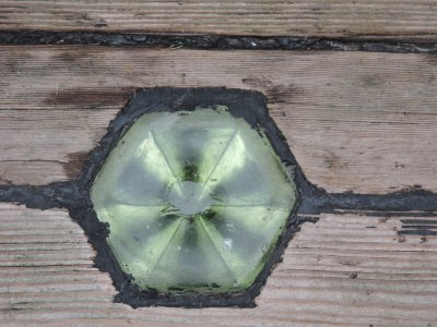

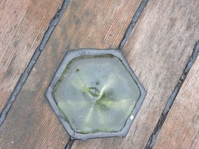

here are pictures the first picture shows a lead caulking the second is a tar caulking

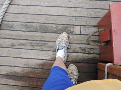

you can judge the size by the shoe to the width of the planks
