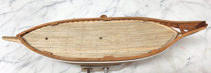

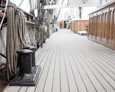

Hi,
Any suggestions for a good lighter coloured wood type to use as the decking strips for my Cutty Sark? The dark red/brown sapele strips I have are much darker than the actual planks on the ship so I want to change them out. Most of the usual suppliers have limited choice of wood types in the correct size in stock at the moment and I don't want to be waiting weeks. Is maple a good choice for decking, I can get hold of that? Lime wood strips also available but may be a bit too white? I also found a supply of limba wood strips at a very good price but I have no experience of that wood, what is its colour like and how fine grained is it? Has anybody used this type of wood and is it good choice for decking?

I have built a deck with all limewood and I didn't like it because it is too light. But of course you could apply a dark stain to get the desired effect. Just my opinion
I have used nordic birch in many models. I cut my own strips of 1 mm or 1,5 mm birch veneer, which is very cheap in this part of world.
thanks for the suggestions. The choice of wood type is very limited from the usual suppliers because of all the supply issues and I do not have the equipment to cut my own strips. Limewood and maple are about the only two light woods that are in good stock in the size I need. Limewood is definitely too white so I have ordered some stains to see if I can tone it down to give a "sun-bleached teak" look. I have also found a furniture veneer supplier that has a good range and I have ordered a few samples of different wood types from them. They only supply edge strips and large sheets so I would need to cut them to the strip size I need but that should be OK to do with a good cutter.
I've always used tanganyika wood for decks. There are plenty of light color suitable hardwoods to choose from. Birch is often used. Some have even used maple. although the grain on maple has little contrast in appearance. Being rather plain, it would work if you are looking to produce the color and texture matching your photo above. Those lookin for darker decks use darker woods, such as cherry.

Mmm. Getting that scrubbed deck, sun bleached timber look. Of course it's really a light grey colour you are trying to achieve if this is the look you are after. There are some timber colouring/aging colours you can get that model railroad folk like for their old sun bleached timber building in the days of steam. I believe Micro Mark sell some products but they will only ship them continental US because of the chemical composition so that hardly helps you does it.

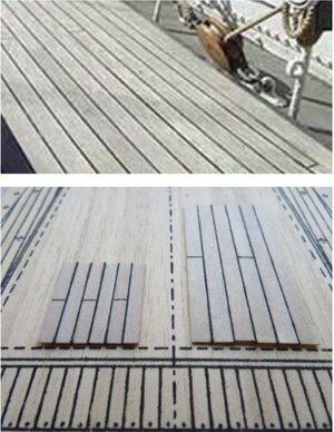

Thanks again for the advice. I was able to buy some little test pots of a variety of grey wood stains from a furniture restoration supplier. I tried them on different woods and found this "driftwood grey" diluted 60/40 gave a very good effect on limewood strips. I made up some small test pieces and they are not far off from the actual planking as you can see in the picture (it looks much better by eye than what comes out in the images due to the camera exposure). I agree that the limewood is a bit soft but I think it will be fine for the decking after a coat of sealing lacquer.
Decision made - no going back!
