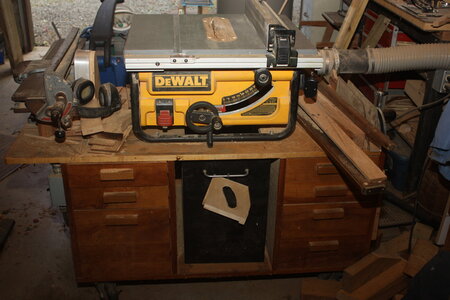

For many years I had a really good 10" contractors saw that served my woodworking needs very well. When parts for it became unavailable I had to dispose of it and started looking for a newer version for replacement. Meanwhile, my son-in-law gave me one of his two DeWalt 10" bench-top saws. To my surprise, it proves to be an excellent saw! Very carefully I set all the adjustments per the instructions in the owners manual and they have held extremely well for a few years now. The table top is somewhat smaller than my previous saw, but the great performance outshines all the bad comments people make about these kinds of saws. It has a 10" blade that I most often use, but I also have several 7" blades, including some fine-toothed planer blades from my portable circular saw. Those blade are about 1/16" thick and the cut very smoothly. If I only built models, I might consider a smaller saw built specifically for modelling, but my DeWalt satisfies all my needs for both worlds of woodworking. Just consider your needs and get what suits you best.
Happy Modelling
Steven
Oops! Forgot to attach photos
Here they are.
View attachment 256321View attachment 256322

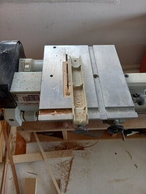

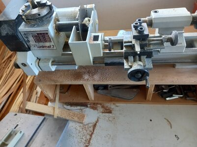

Maybe it is an idea to buy a lathe with some additions, like for instance a table saw. I have a small Unimat lathe (just 40 cm), which works very well and the table saw was the best thing I ever could lay my hands on. It easily saws up to 1 cm thick pear wood. Actually I won it many years ago in a contest, organized by the import firm here for Unimat stuff. I never looked for any kit again.
View attachment 256534 View attachment 256535
