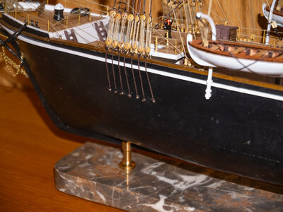

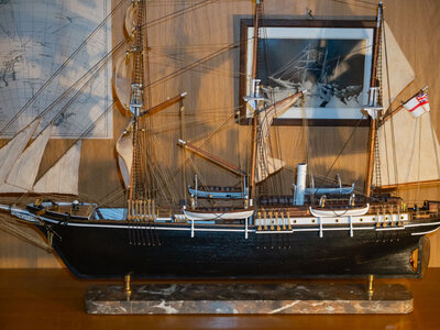

Hi there
I am just finishing the same kit and I purchased this display stand and with a little adjustment fits really well.
Hi there

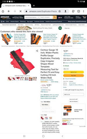

Hallo @Umb80
