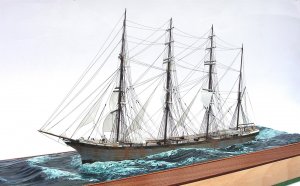

Sails or no sails, if you display them properly, you don't obscure much at all. Take this one of the Loch Torridon, the model is viewed from the back of the sails, and not from the ever-popular front! In this way, hardly any rigging is hidden and this ship is considerably more complicated than Napoleonic warships. The other model, of the barque East African, has furled sails, and they look OK as well, because they are in the correct proportion. Sails on a lot of static models often look bad because they are too thick and chunky.
View attachment 66823View attachment 66824

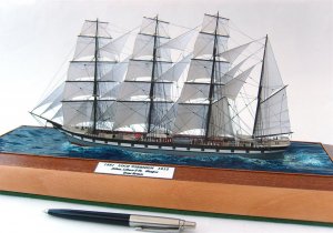

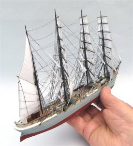

These two have shaped sails, but they are scratchbuilt. Kit manufacturers seem to be incapable of producing realistic sails, so if you want reasonable ones, the only option is to make them yourself. To me, if they do not have a wind-filled shape, they do not look right. Nothing worse than flat sails and flat flags!
