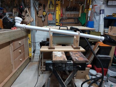

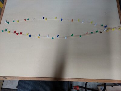

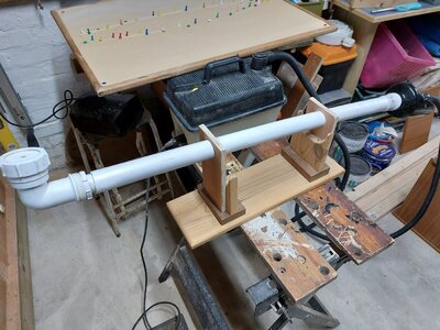

Here is a simple DIY Steambox I made from PVC pipes and a wallpaper steamer to allow me to bend strips of wood for the rails for my Bluenose model. The nozzel from the wallpaper steamer is inserted into a hole in the end cap of the angled pipe , the other end of the pipe is capped, and the cap has a hole to vent steam. It worked a dream! I hope this helps members who may be concidering building one.
