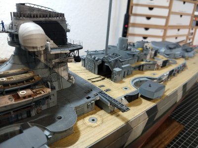

Hello everyone, here is the construction report of my Bismarck model from the Trumpeter brand in the scale 1:200.
The Pontos Detail Up Set “Advanced” is used for optimal detailing of the model. Various Veteran Models sets and all sorts of other aftermarket accessories do the rest.
Not to mention a bunch of styrene profiles for scratch building and the famous leftovers box.
I’m trying to create a model that shows the period from April 1941 to about 80% historically correct.
I worked on the model for almost two and a half years and it was finished in October last year.

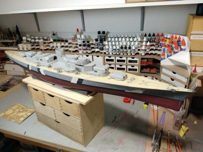

This is the start:

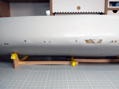

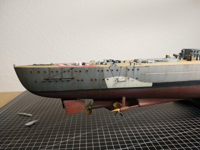

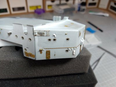

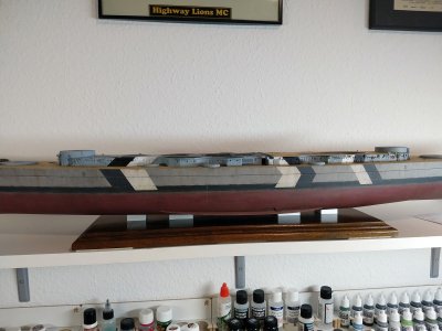

The torso needs my attention first. Portholes have to be built up and the cooling water intakes have to be added.
The original kit is missing the sacrificial anodes on the shaft pants.

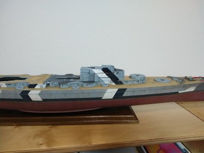

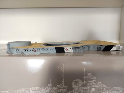

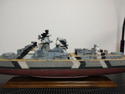

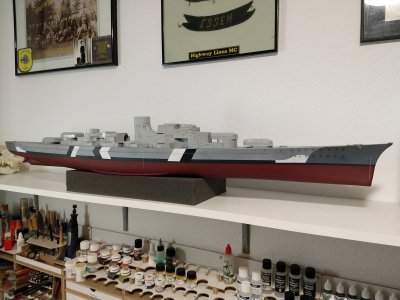

I had decided to apply the Baltik camouflage scheme. She simply looks her best this way. But I didn't know what work there would be on the superstructure.

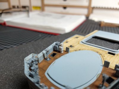

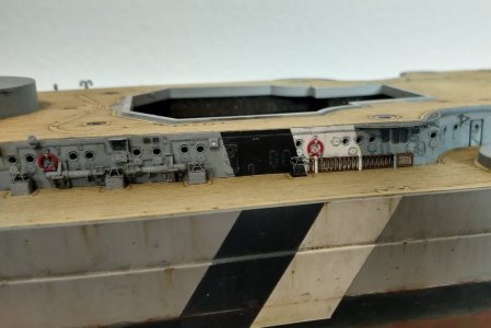

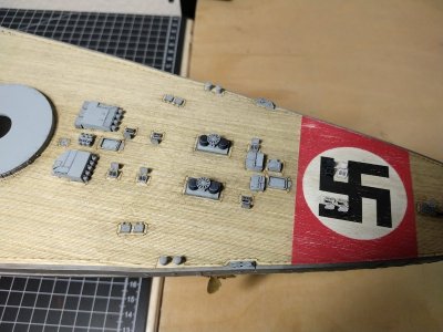

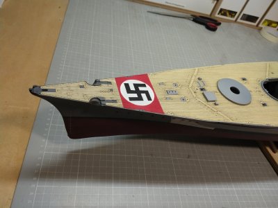

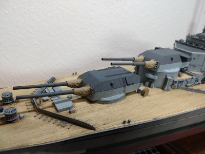

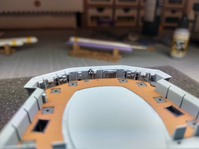

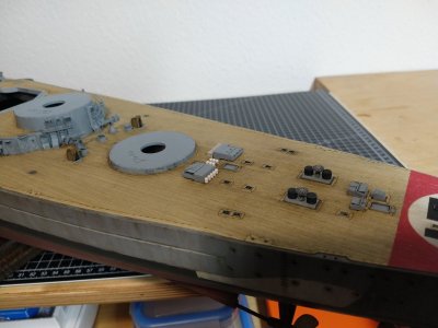

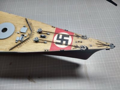

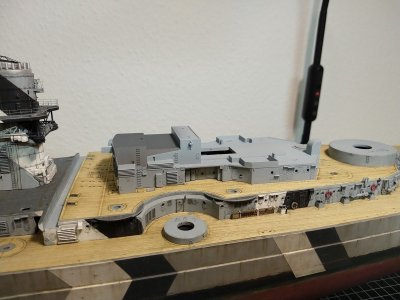

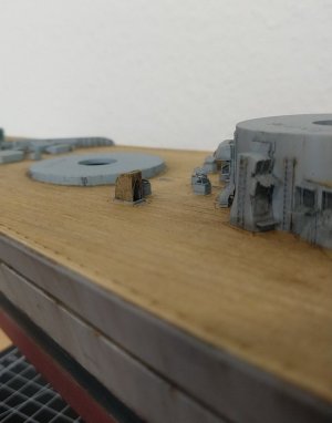

The wooden deck of Pontos simply looks authentic.
I think the deck from scaledeck is nicer, but unfortunately it came onto the market too late.

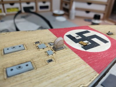

Then comes the swastika in the aircraft identification, which is banned in Germany.
Naturally painted, no decal.
This way you can better see the grain of the wood.

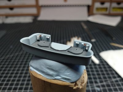

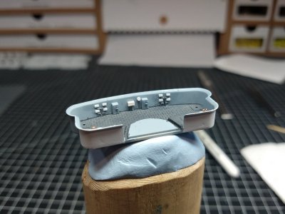

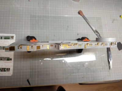

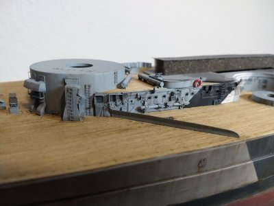

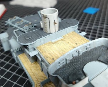

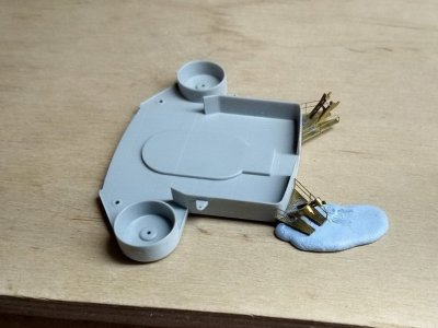

Then the first fine details of Pontos come onto the lower superstructure.

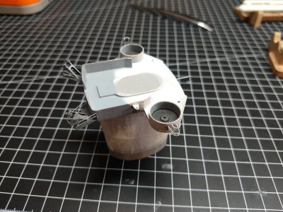

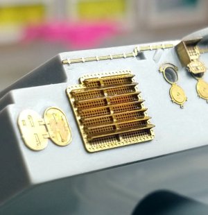

A close-up of this fan shows the depth Pontos brings to the model.

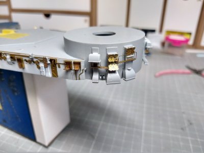

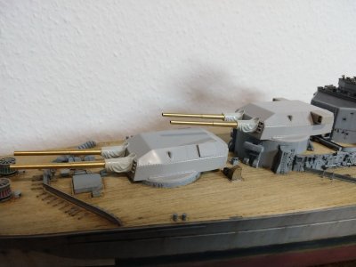

The fan details on the front barbette are just great.
All sorts of missing details are added with styrene profiles and lead wire.

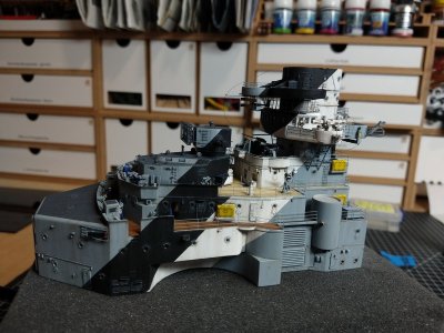

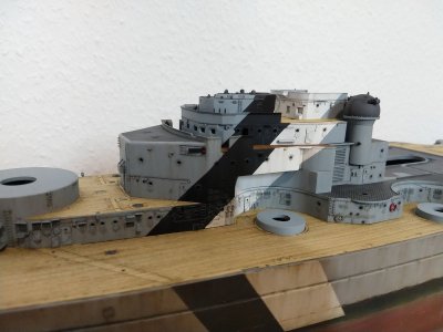

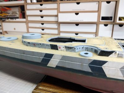

Now the camouflage stripes had to be built on top of them.
And glued to the deck.
And then the ship comes to its final position, because next the rear superstructure with the deck and closes the hull

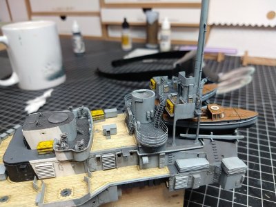

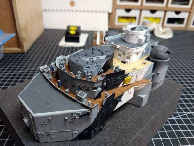

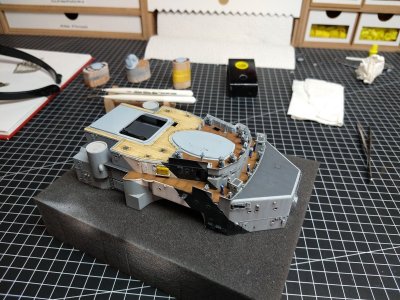

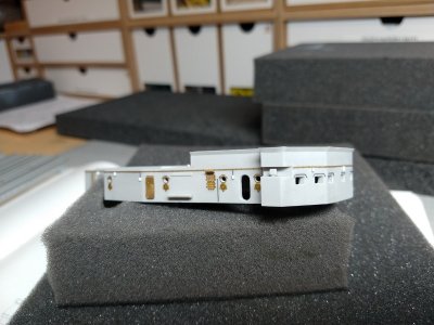

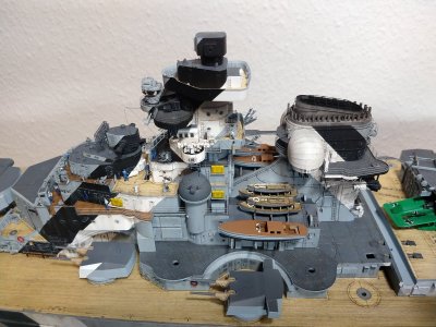

Let's move on to the next floor of the superstructure.
Missing details were corrected using Styrene profiles.
All surfaces still showing above were painted dark gray in 1941.

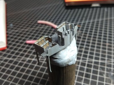

Continue to the next floor. Only a little styrene was required here.

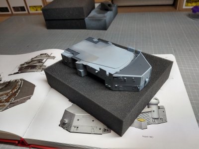

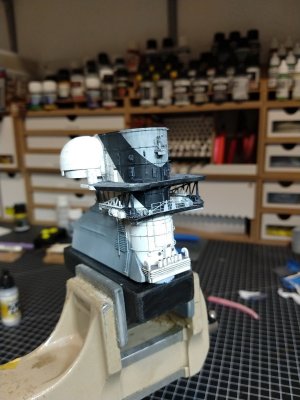

In order to find the right angle for the camouflage scheme, a mock-up test.

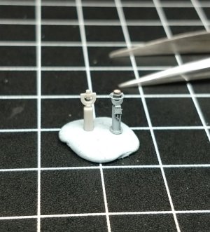

The compass is excellently detailed. I probably won't have to mention which one is the original.

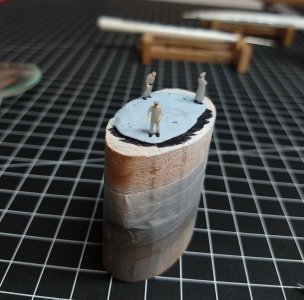

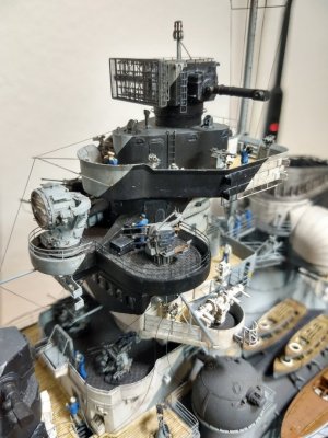

To add more life on deck, I got the very good figures from Northstar in a variety of activities.
But painting is really Sisyphos work.
And the first sailors come onto deck.

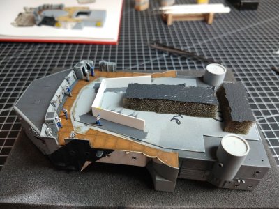

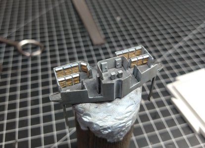

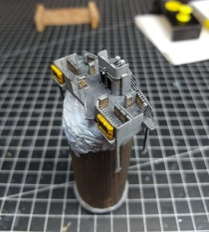

The doors of the next floor were opened, so I put in an interior wall and the next level could be glued.
Some things had to be corrected again on the tower segment.
Likewise at the front artillery position, which could then also be installed.

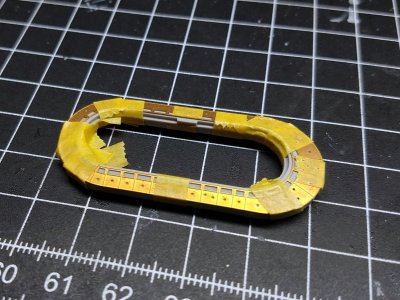

Then the crane booms. Again, a very delicate work. Here I soldered the parts to get more stability.
And then he can go to the gallery.

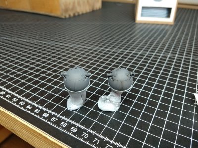

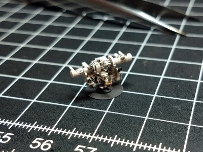

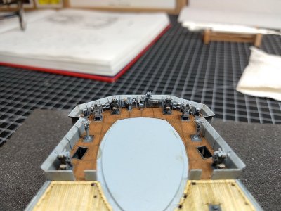

But the 2cm C/30 gun from Pontos is also impressive.

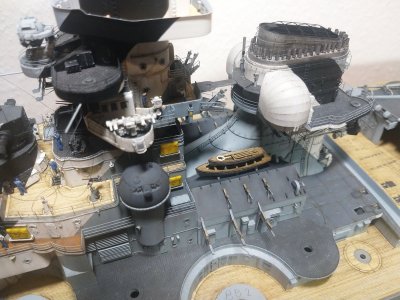

The tower slowly grows taller.
Finally, another test to see if everything fits together.

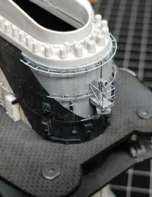

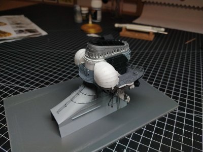

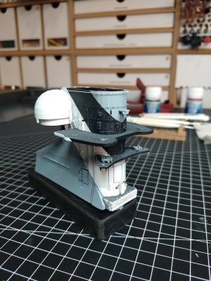

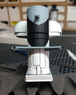

Then let's move on to the funnel.
Here I had to proceed differently when painting than with the superstructure. Since it is extremely detailed, I painted the camouflage stripes in front of all the attachments. Otherwise it would not have been possible to mask him properly.
I then laid a variety of pipes using lead wire.
And so the funnel gradually fills up.
The pipe also received a small Styrol upgrade from me.

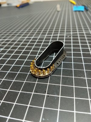

First get rid of the rough plastic tubes.

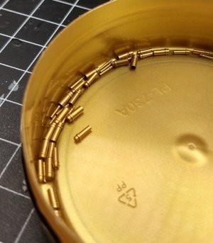

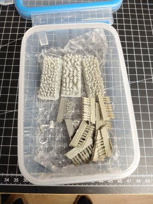

And sorted what felt like 1000 brass tubes from Pontos.

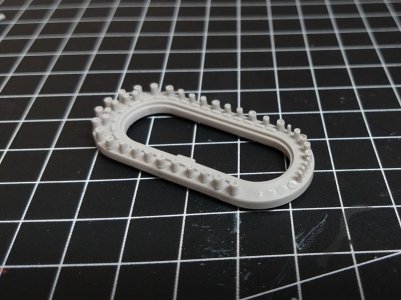

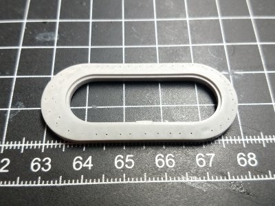

One of the things I particularly like about Pontos is their drilling templates.
No matter whether it's for the tubes or for the crampons on the hull or the superstructure.
It couldn't be more accurate. That's why I prefer Pontos to KA Models.
Absolutely 100 percent hole spacing. That's the way it has to be.
Then the holes are drilled out and the pipes are put into place.

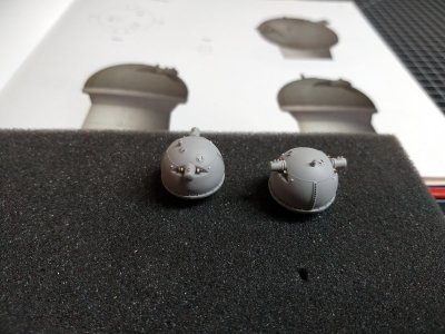

That's why the coronation now follows. Note that unlike the Tirpitz, the Bismarck has an aluminum cap.

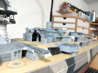

Let's take care of the little things on deck.

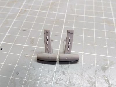

First of all the paravane called otters and the rear breakwaters.

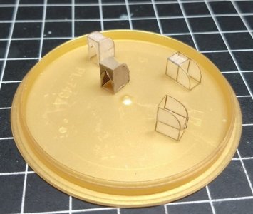

Here are the skylights improved by Pontos.

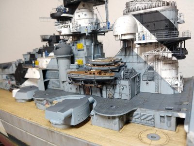

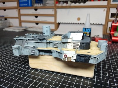

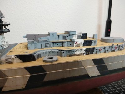

We come to the rear deckhouse.
Here you can see very clearly from the crampons on the right what the drilling templates from Pontos will do.

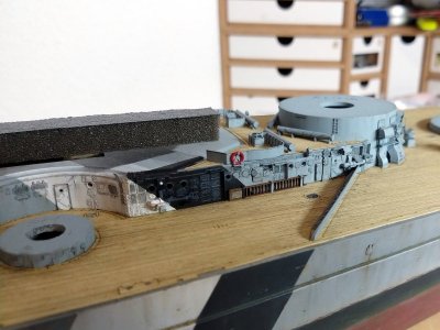

First test. I need to show the lower part of the main mast and cover some of the inside because I want to show the hangar open.
There was also a little scratch work missing on the night control post.
And towards the bow.
The deckhouse grows and is adapted to the original ship. Here too, the kit is missing some details like parts of the gangway.

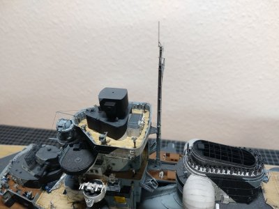

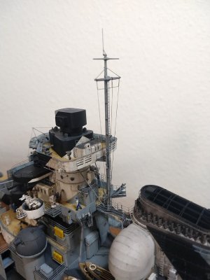

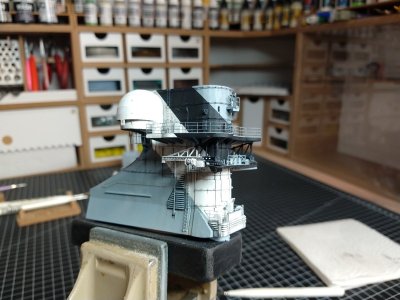

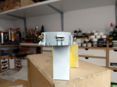

Now it was time to prepare the upper part of the tower.

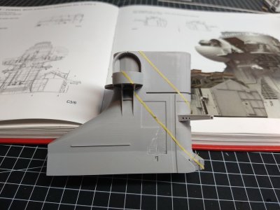

The obligatory angle check.
First fix the bridge between the tower and the funnel and then go to the front hangars.

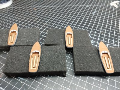

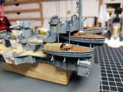

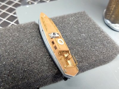

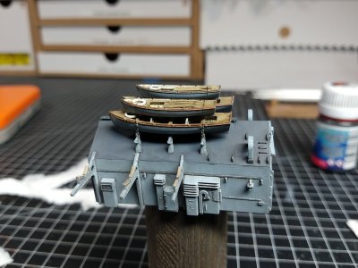

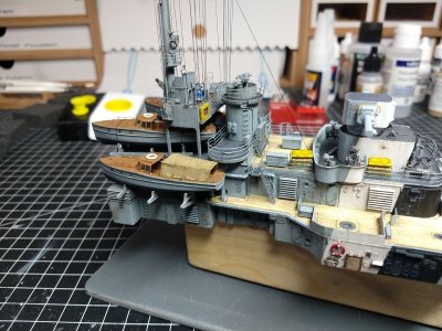

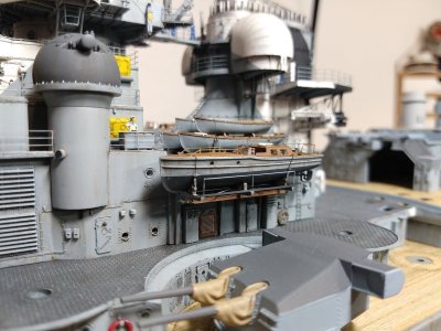

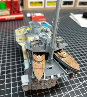

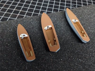

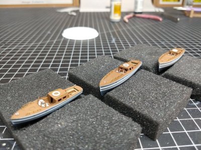

I really wanted to build the small boats. They were secured with rigging twine and rope tensioners.
Then it was time to produce boats like on an assembly line. Here too, a little scratch to refine the fittings.
Align with the boat cradle
And finish building.

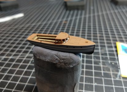

The admiralty boat is also amazing.
Now it was time to raise the foremast and equip the top gallery.
The struts, railings and signal lines were still missing.
Now the boats could also take place.
Here you can clearly see that the underwater hull of the boats was not painted red but dark gray.

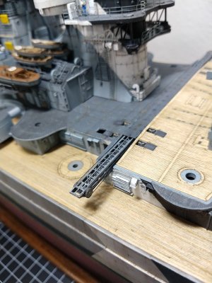

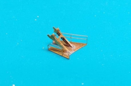

Still putting the Pontos catapult together. And installed.

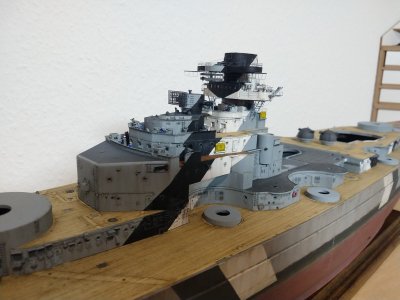

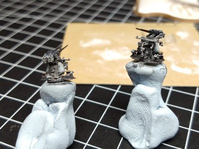

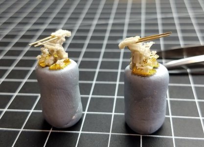

The next 3.7 cm twin mount from veteran and a cleaning crew.

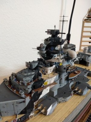

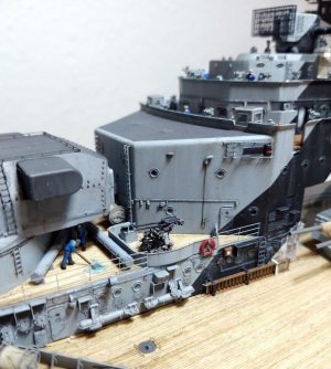

Then let's finish the tower. Start with the fire control.
The camouflage stripes are already on here too. I then paint the etched parts later with a brush. These fine details simply cannot be masked.
And so he can get to the top.

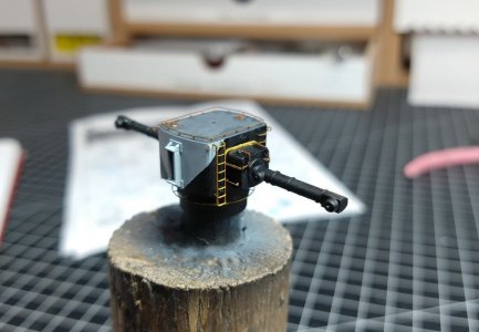

All that was missing was the 2 cm C/38 quadruple mount.

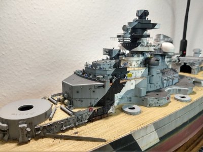

This completed the front part of the superstructure.

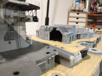

Let's go back to the rear deckhouse.
The base of artillery direktor D missing some details.
And finished the two Boat cradle.

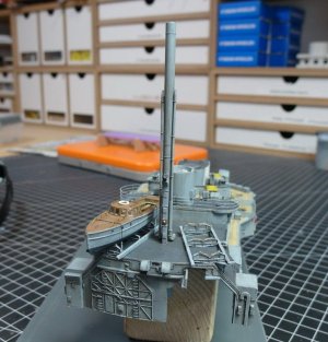

The lower missing part of the main mast in the hangar is created using a profile.
And this is how it can be installed.
Pontos still supplies the rail system on which the onboard aircraft were pushed. This will still play a role in my model.
On to the next mass production.
This time the transportions boats.
The first one takes up space. The lower part of the main mast is also being refined.

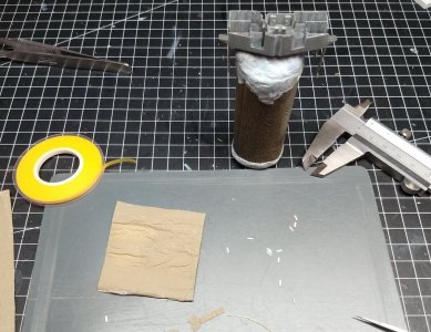

And again cellulose paper is needed.
This time for the signal bridge.
The signal flags that were stored here are covered with a canvas tarpaulin.
This is completely missing OOB. It couldn't stay like that.

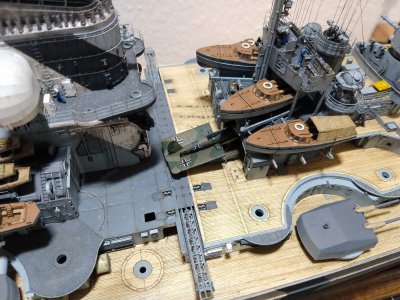

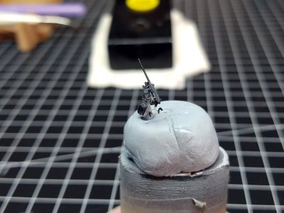

Now we come to another special feature of the DKM. The Bismarck carried the army's 2cm Flack 30 on board.
It was therefore mandatory to also carry the trailer called “Sonderanhänger 51”.
German complicated legislation.
But Pontos also thought of that. They just forgot the tires. I then printed them out.

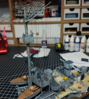

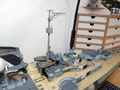

Then the next delicate part of the main mast for guys with strong nerves.
And on with it.
Now the signal lines could be pulled.

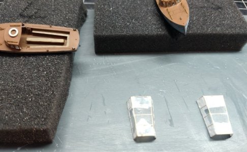

One last time I had to use paper tissue and wood glue. Tarpaulins had to be made for the transport boats.
Starboard
Portside.

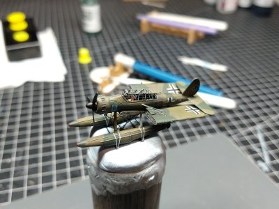

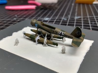

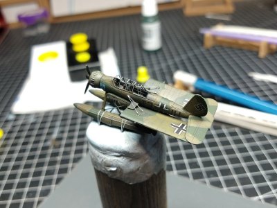

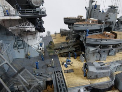

How about starting a little performance.

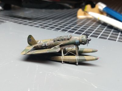

The Arado AR 196A floatplane is usually most shown standing on the catapult ready to take off.
But since Pontos already provides the removable rail system, I wanted to simulate a little exercise of how the bird is pushed out of or into the hangar.
I have original pictures of this scene that show such an exercise.
First Test.
Then I repurposed a few figures and modified them a little...
I think that's how it works.

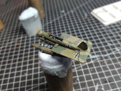

Cockpit installed
The Arado also becomes a small work of art with Pontos.
She is attached to her sleigh with the white rigging thread, which cannot be seen.
And still glazed with Micro Kristal Klear.
And that's how I implemented the scene.
The officer shouts, the sergeant also shouts louder and a mechanic tries to repair the hydraulic jacks.
The pilots are laughing their heads off.
