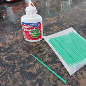

  • CA glue (super glue): Fast, strong bond, often used by modelers for copper plates.
  • Epoxy (5-minute or longer set): Excellent for bonding dissimilar materials like metal to wood, offers stronger and more permanent adhesion.
  • Contact cement: Can work, but is messy and less precise for small plates.
Use a thick CA, the setting time is a little longer but gives you some 'wriggle time' - thin CA is almost instant.
