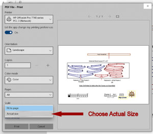

First things first are getting the plans printed out. Since I have an HP 7740 Wide Format printer, this is at least one fortunate thing. Printing plans from pdf are not my forte'. However, a few adjustments needed to have the correct dimensions reflected correctly on the sheets.
I would like to expound on this if you do not mind. In the printer settings (advanced settings) there is a drop-down to choose between "Fit to Page" and "Actual Size". The default setting is "Fit to Page" and seems logical. I printed out a test page and from initial observation all is ok. But, closer inspection reveal that this is not the case. The first item to print was the Keel. One notch seems ok until I measured the full length and noticed a problem. Then I remembered the "Actual Size" selection from a long time ago dealing with the same situation. Printed the Keel again and it is now EXACT. I need to mention that the difference is NOT noticeable at first. the dimension difference is barely noticeable, but the dimensional error does add up. It is NOT the plans. It is the way the printer makes internal adjustments.
So, I include a small screenshot in case someone has this dilemma. Also, my basic printer dialog setting has "Tabloid" instead of the usual 11x17 settings. The tabloid is fine. Please take note that you might not have this problem. If you have a printing company doing this for you, mention "Actual Size". For those that already know this, then disregard as this is a new experience for me.

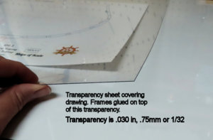

The next item that I felt was important was what method I was going to use to build the frames on. I must give credit to Norway (Knut) as I read his log on this. So, since my wife works at Hobby Lobby, I was able to get a 23 x 18 sheet of glass really cheap and it is 1/8 inches in thickness. I also grabbed a very thin transparency sheet. This one sheet is about $1.50 so, it is not major to buy more in case glues makes it messy.
I am not sure how this will work, but I think it will be ok. The glass serves as a strong flat surface. Then I lay my plan on the glass, then on top of the plans, I will lay my transparency sheet. The sheet is .030 inches, or 1/32", or .75mm in thickness. It seems so thin that I cannot tell the transparency sheet is there. Below are some samples of such:
Now this image below is just that the plans sheet static clinging to transparency. Kind of optical illusion.
It looks like the plans are on top, but the plan is underneath the transparency.

Very good idea with the transparent sheet - I will give it a try also next time.

Donnie, I also used a transparent sheet, but during gluing I used double-sided Scotch tape
such as Dave.
I don't know if this is the best way to do it but I got it this way, picture in my log.
I'm also excited about how you check the drawings to find out if everything is in the right scale.
Greetings Knut-

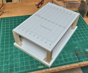

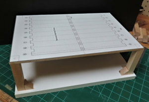

I agree that it is probably best to choose a wood that has good machinability and workability rather than the colors. I spent this evening working on the Jig. Mike says that the Jig does not have to be a work of art. The bottom is a pre-made 12"x36" shelf and 1/4" MDF 2x2 foot sheet. bought at home depot.
No, it is not glued up yet,. I just showing a dry fit.
We can compare the size with your glasses - Already we can see the difference in size between the "normal 1:48 and your scale.
This will be a "big" section - BTW: Looking very good

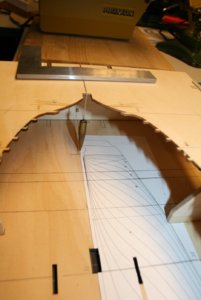

Good start, Donnie. The most critical step is coming up: transferring the keel position lines from the jig top to the base. The positioning of the keel is crucial. One way to do that is to cut the base the exact same size as the top. Then the supports will align at the corners and you can take measurements of the keel position off the top and simply transfer them to the bottom. ( I hope my explanation made sense,)
Or with a perpendicular or lead, like I do it normally - If you have one, it is in my opinion that fastest and most accurate possibility
