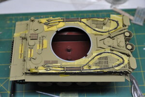

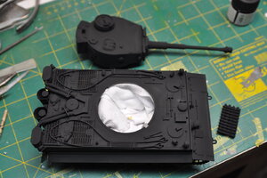

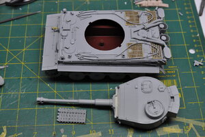

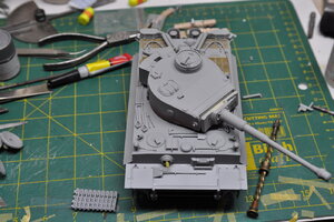

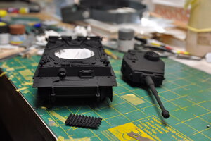

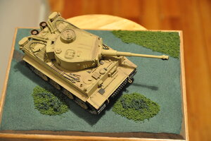

First photos show model in surface primer. All large areas are air brushed.DSC_0669.JPGDSC_0669.JPGDSC_0671.JPG

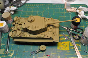

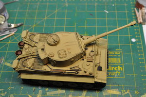

Next shows a shading coat.
Final color applied.
Masking equipment and hand painting equipment.

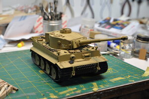

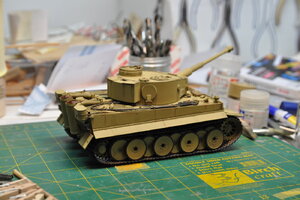

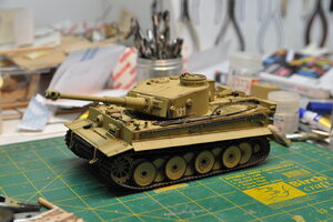

I carried out some weathering, after watching numerous YouTube videos, I tried using some home made washes together with low cost pigment from a local art shop. Quite a bit of experimentation was done off the model in order to get a feel for what I was doing as the learning curve was quite steep.
I didn't want to go overboard with the weathering.

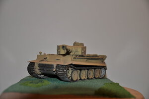

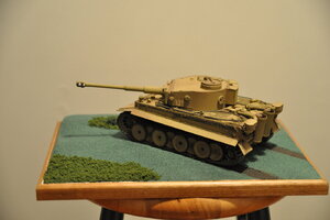

Next I built a base, contouring was achieved using left over plastering products, I wanted track impressions in the base so when the plaster was still workable I wrapped the tank tracks loosely with some plastic sandwich wrap and pressed the tank into the plaster this gave me the effect I was looking for which is the tank going across a field whit the ground being fairly soft but not boggy. I mixed up a color of flock to what I thought was about right and applied it to a layer of white wood glue PVA, I also mixed up a color and painted where the tank tracks have broken through the grass.
Again a fair bit of time was spent experimenting with different materials and trying to develop some sort of technique.
At the end I was fairly happy with overall result, for my first tank model.
