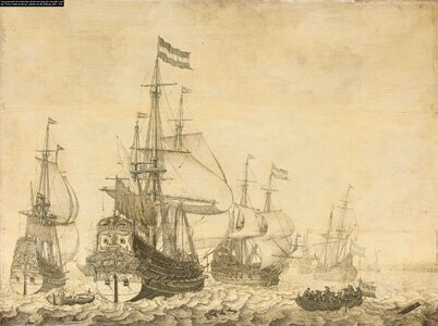

Hi everybody. Finally I can be back to this forum after a few years. I have some builds material to post here, namely the finished 1763 Sherbourne, a Bermuda Sloop ongoing, the ongoing "Queen Anne´s Revenge" of circa 1710, based on the elements we know of La Concorde de Toulon and I started recently the investigations on the title of this thread, the Drenthe (or Drente) circa 1637, a yacht purchased from the Admiralty of Rotterdam with funds of the province of Drenthe during the 80 Years War.
A great detailed description of this ship´s actions are described here http://oud-schoonebeek.nl/index.php...ldaten-in-drenthe/255-drenthes-strijd-ter-zee
I search and study all images I find of the period and these early frigates without the quarter galleries keep fascinating me so I decided to study them and build one. We have its dimensions, so from there I can work on, but my question to anyone who may help, is about the coat of arms we see in the taffrail.

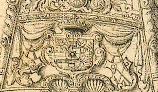

In the image below, the Drenthe is the first from the left and this is the detail of the arms. I still couldn´t find any exact match to any province or related that looks like it but I keep on searching.
Is anyone able to give me some references on how to decipher this enigma?
Best regards to all builders.
P.S. The fluyt on the far right is also going to be a build :).

First of all a warm welcome back here in our forum.
So we would be very interested in your project and off course highly interested in this one
Did one of the de Veldes painted this ship once more or is it the only painting or sketch the Drenthe is shown?
Maybe something in this book?
WE have some specialists of dutch ship building in our forum, f.e. @Maarten (he has a Van de Velde in his kitchen !!!!), @Ab Hoving @-Waldemar- , @flying_dutchman2 (to mention only some) or others, which knows maybe more, but defintely they all will be interested in your research
