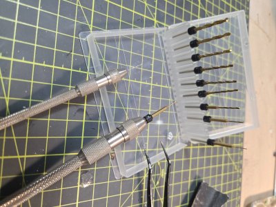

Ordered via Amazon, fast delivery. I've been drilling out blocks using the small pin vise. Tried the new bit, worked great. Especially like the longer shaft which allows me to use a bigger pin vise, easier to handle.
