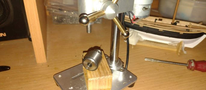

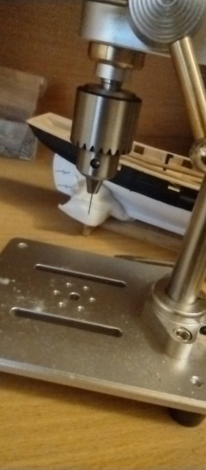

In my machine, the chuck is compressed to 0. In the picture, the drill bit is 0.5mm.
As is should be! This is one of the things about Chinese machine tools that takes some getting used to. The exact same model tool can often be manufactured to more than one set of specifications. They make them to the buyer's specifications and price point. Tight tolerances cost money. So do zero-closing adjustable drill chucks. (A really good micro-drill chuck can run more than $1,000.00 USD: https://www.grainger.com/category/m...afCatRedirect=true&searchBar=true&tier=Tier+4)
The model you have apparently came with a more expensive universal chuck.

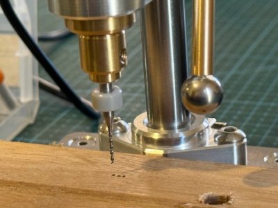

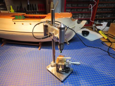

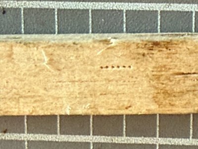

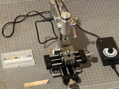

From the same vendor (AliExpress) I purchased an XY slide and fitted it and a very small toolmakers vice to the base. The second photo shows a series of holes drilled with a 0.4mm carbide bit into 6mm thick wood. Without breakage. If I make another model ship I will happily use this tiny, quiet, cheap, accurate setup to drill masts and spars and belaying pin racks. BTW, if I was to use only one drill press I would choose something a bit bigger. But I do have several others. The one in the photograph is the only one which I would use while SWMBO is watching TV in the same room.

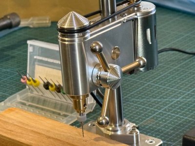

While considering my next build, I spotted advertisements for a tiny watch repairers drill press. And I bought one. $AUD98 from AliExpress. Including postage. (see photos).
I must say that I am delighted with the Chinese made tool. It is beautifully finished, feels tight, and it is very quiet. It IS tiny. The power supply plugs in on the side of the drill which is a bit inconvenient but not a deal breaker. The power supply also houses the on-off switch and speed control.
I chose the model with a non adjustable 3.175mm (1/8") chuck, which accepts only drill bits with a 3.175mm shank. Fortunately they are available in tungsten carbide sets very inexpensively ($AUD5 per set), and they fit snugly in the chuck. My previous experience with small cheap 3 jaw chucks showed that they are not particularly accurate, and it is easy to misfit tiny drill bits into the gap between adjacent jaws rather than centrally. The ER collet model should be OK, but extra cost for that model, plus the cost of the collets, plus the fiddle of changing the collets when changing the drill bit size were factors in my choice.
So, at this time I have drilled a few experimental holes, and it seems very good. I plan to fit an X-Y axis movement table, and will probably fit a larger securing knob for height setting. Those tiny carbide drill bits a very easy to snap, but with the work securely held, and the drill press ensuring no lateral movements, breakages should be rare.
I think that this tool will be popular with model ship builders.
That's a nifty little cross slide there, and reasonably priced, too.

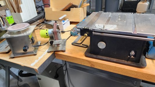

The drill press question seems to be a constant one here on SOS. In general when buying stationary power tools I believe in getting largest that you have space for and can afford. Large power tools can usually perform work on smaller things but smaller tools quickly reach their limit on larger work.
There are exceptions. I would not try to rip 1/32” strip on my 10” table saw; that’s what my Byrnes saw is for. A drill press is however not one of these exceptions; larger is more capable and with the right (inexpensive) tooling can be used with tiny wire sized drill bits.
There are three factors: the size of the chuck, the maximum clearance dimension between the chuck and the table, and the distance from the the centerline of the drill bit to the forward edge of the column. In my opinion the little drill press posted above fails two and possibly all three of these factors. I don’t know the chuck size. Minimum for me is 3/8”.
Floor mounted models now cost $1500 and more, but a larger bench mounted model is a good alternative. My bench mounted model is still chugging away after 50 years of almost daily use. Big box home improvement stores offer store brand model bench mounted drill presses at affordable prices. They’re worth a look.
