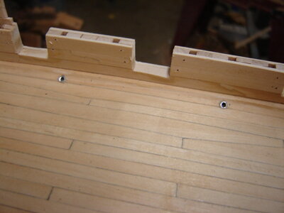

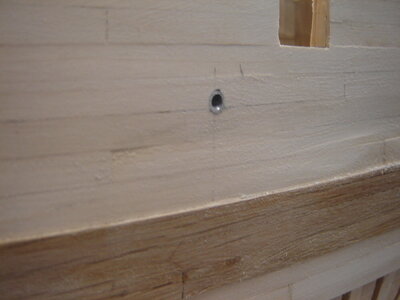

Don, applying tape over the area and marking your drill marks on the tape will prevent edge splintering. The tape and type of wood are the variable. Painters tape, thin Monster tape, even Scotch tape can work. I've had better results with thinner tapes. I always test exactly what I am attempting to do OFF the model, if I've not done it before, specifically, i.e., if it is a different wood, if the angle is different, if the hole is a different diameter. I just mount the type of wood or material, for that matter, on another scrap piece of wood. Then apply a number of different types of tape and start drilling. Remove the tapes and decide if any, which is the best result. Only then do I have to confidence I will not be risking all of my hard work on the model that came before it.
Best of luck!
Ken
