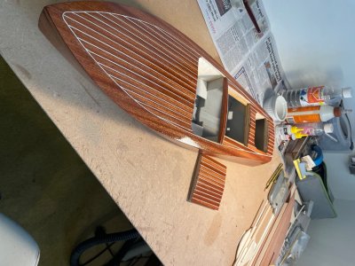

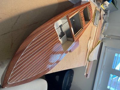

That is one superb model, illustrating the precision and prettiness inherent in the planking. Very well done.Time and patience… considering I am new to this, I think I’m doing OK… so far…
If I may make a suggestion, it looks as if your varnish is showing a slight orange peel effect which could be the grain texture telegraphing through. To remove it requires careful rubbing back using 400 grit, then maybe 600. Thin the varnish and use a quality brush to apply further coats, allowing 24 hours between coats. If your finish has sufficient body you could move to a wet abrasive for the final stages.
If you look around for finishing systems for car paints, there is plenty of explanation. Be good to have a glass like finish just as on the original.

Next time around then. It was a good while in my day job apprenticeship years before the need to do things like grain filling before applying finishes, and taking care to de+nib on every coat and thinning lacquers , and French polishing and making up dust excluding tents, and top coating in the morning when the airborne dust has settled, and.. and…

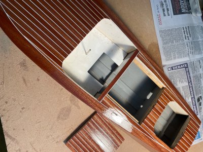

Hi ENJAY49,Nice work, Namery! I've done 4 similar lake boats, 2 Dumas, but took the lazy way out. To avoid measuring all the curved deck plank edges one at a time, taped the planks & caulking together, on a workbench. With a carefully made template over them, cut the taped planks & caulking out, then glued to the deck. Luckily, works out fine, no gaps at all. (Used spar varnish, nice gloss, and. no, I'm not recommending my way!)
You're right, slow & steady is critical. but if I can save save time without negative results, I'll take it. (On my Victory, I cut out the gunports with a Dremel sircular saw, saved so much time!). Funny, back when I was first painting cars, I was shocked when told to sand my nice, glossy clear coat!Hi ENJAY49,
Like the idea of the template and the cutting and caulking
I did each plank individually but was determined to go slow and gentle.
Have to say she’s come on again after I heeded the finishing advice given by the kind input given in another reply to my thread.
Thanks for your feedback. Be good to see your creations!
I’ve got to put the running gear in and a long way to go but again, slow and steady…
