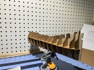

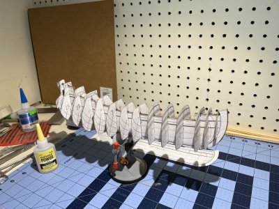

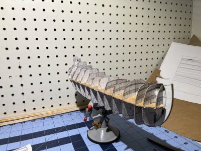

Hello,
This is my first post here so forgive my lack of substance or ettiequte.
I am a pretty inexperienced at building from scratch so I've decided to try making a dutch fluyt of the mid 17th century in a scale pf 1"=10'(Amsterdam feet). I'd say it's a pretty hard project to start with but as the saying goes "go big, or go home."
Ab Hoving was very kind and sent me the lines of a 105 foot long dutch fluyt.

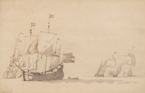

I am not yet certain what the name of the ship will be or the specific details, as it is not based off any specific ship. I am thinking it will be more of a form exercise as I was inspired by this Van de Velde drawing.
I also lack the knowledge of most technical terms, but so far have the keel and frames of the ship put together. so far the ship is about 11.5 inches.
I have placed a dap of glue where the frame sits on top of the center board, this will allow me to adjust the frames to ensure a perfectly parallel fit.
If it looks like I'm doing anything catastrophically wrong please feel free to write a comment.

Hi,
Congratulations with your fast start of the project.
Model shipbuilding is mainly a matter of planning. How did you plan to remove the tops of the frames after they have become obsolete?

Hi Ab,
Thanks for linking your tutorial, it was one of the inspirations for starting this model actually.
At the scale I’m working at it will be difficult getting scissors in to cut away the frames after the sides have been planked.
Once I get to that point ill see if they fit but I might have to snip at it from multiple angles to get the excess out.
I will be away for work so that won’t come till later…

I'd like to try one of these, so I'm looking forward with interest to your card stock build. Out of curiosity, where did you purchase the card stock you used for the frame, and how thick is it in millimeters? Is it easy to cut with a cutter knife, or did you have to use a small saw of some sort?
Hi!
Thank you for your interest,
I’m using 0.75~ mm card stock. I bought it at my local Micheal’s and if I were to change anything I would buy some that is exactly 1mm in thickness. Choosing the thickness of your card is important as you must factor the thickness into certain calculations.
I can cut it with a craft knife, but you have to go over it multiple times. When doing long cuts I use just a good pair of scissors.
You could always layer multiple pieces of card together to create thicker sections, especially if you’re gonna work at bigger scales.
