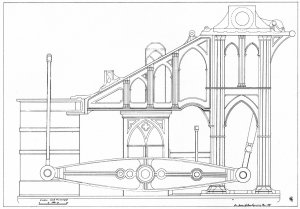

I am playing around with the Cairo steam engines which the doctor is a part of that system. I like working on several projects and ideas at one time. They are all related to one another so what I learn with one subject I can apply to another.
I am thinking of a X section of an early naval steamer the ship I came up with is the first steamer the navy built which is the Mississippi 1842.
what makes this interesting is the engine I think a dummy non working model would be really nice.
I picked this ship and this engine because the engine was designed in the gothic style and looks like something that belongs in an old European church. This was a time when machines were built as works of art.
Then there is the sheer size
that lever at the bottom weighed 6 tons the frame structure was a single casting 18 feet high 20 feet wide and 1 foot thick. The bedplate this engine sat on weighed 15 tons and was bolted to the floor timbers with 2 inch dia bolts.
there is a complete set of drawing for this engine someplace in the national archives. The problem is finding them is like looking for 1 needle in 10,000 haystacks.
the navy soon realized these massive engines were using 1/2 ton of coal an hour. which was to expensive to just cruse around.
this can be taken to the next level by a model engineer if someone wanted to make the model actually move.
