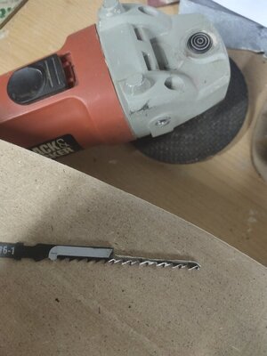

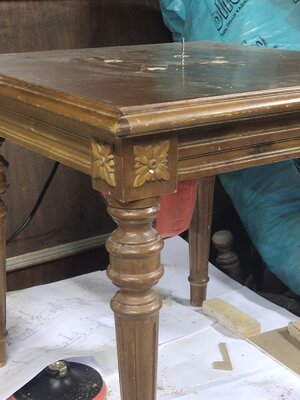

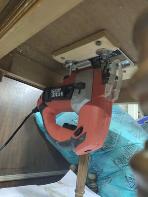

My table jigsaw was sent for repair. However cause of lockdown new part, power adjusting rotor may take weeks to arrive. And there's work to be done. So while browsing find this idea. It took me 20 minutes to built it as I had a spare table on hand.
I also did a bit of improvising
Μaybe a battery fan would be useful to blow away the leftovers and keep the cutting line clean. But until I get it, my jigsaw will be ready so I should stick with what I have for now.

Nice solution to your problem.
I hope that wasn't one of the Admirals best tables. ;)
That modified blade looks very fragile to me.

the blade is quite thicker than this i have on my Dremel tool even after trimming. Al low speed and for wood <5mm thick it will be fine.
As for the table i managed to make it usefl at last:). Besides is just a few holes, some filling and fresh paint will make it up.
