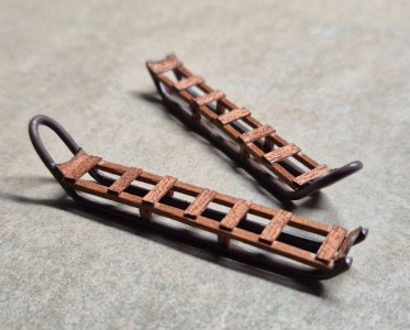

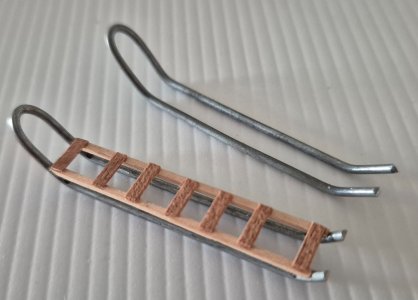

OK, got both of those sleds done and pretty pleased if I say so myself :p
Very simple, 1.5mm fencing wire and off-cuts of timber sliced to size and glued in to place. :)
Anyone interested in having a crack, the dimensions I tried to keep to scale (1:70) are 8mm ~10mm (3/8") wide and about 50mm (2") long

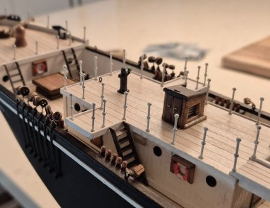

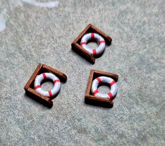

Also I've been looking on line for ages to try and source some 3D printed or plastic life savers but could never find anything close to suit the 1:70 scale needed.
In the end I found some rubber "O" rings of the right size, about 12mm (1/2") diameter, painted them white and added stripes with a paint pen.
A few bits of timber to represent a housing, eh Voila !
Happy Daze Thumbsup;)

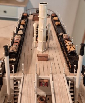

I think that's as far as I'm prepared to go with that little whim.
There's a fine line between enough and too much, not sure where I am on that border but I don't want to cross it too far :rolleyes:

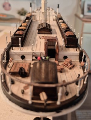

I've made a few bits out of clay to represent tarps, bags and rolls of "something", I've "tied down" a few on the sledges.
I've put those lifebuoys in place too, there will be 2 more on the rear safety rail later on.

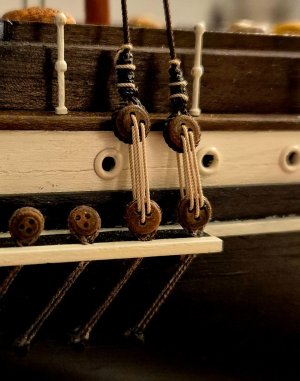

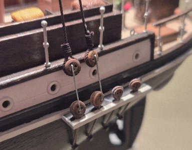

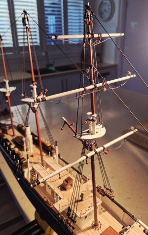

My very first deadeye attempt :p
Very pleased how they look, of course the pressure is on now to make sure all the rest look exactly the same ROTF
I looked at other Endurance in here, and looked at (where I could) some pictures of the original ships deadeye rigging, and decided
I liked that 3 x wound look so I strived for that Thumbsup

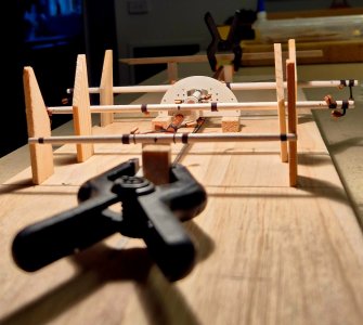

For "jigs" I used a few modified staples.
I've seen some awesome jigs in here but I think they're a tad beyond me.
Also, a tip for other first timers, get yourself some miniature crocodile clips from an electrical store, heaven sent ;)

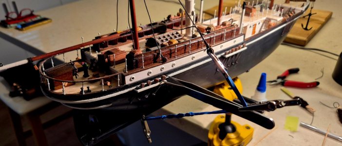

Another "hack" if anyone's interested.
Using a few afore mentioned clips, some rubber bands and a set of tweezers, I managed to create sufficient tension and more
than enough room for my fingers to reach around to secure the deadeyes Thumbsup:)

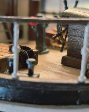

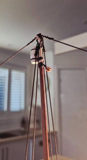

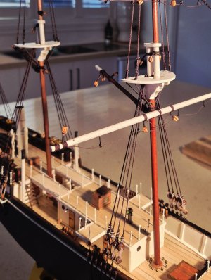

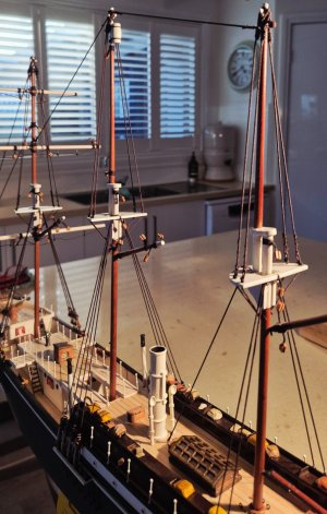

Well, its been a month and I never thought I'd say this about rigging, but I'm genuinely enjoying this part of the build.....well, so far anyway ..
I've studied a lot of pics of other builds in here, and have taken on board a few ideas from them, and added a few "cheats" along the
way, and not to mention the 2 quarts of CA used to keep it all together. ROTF
So far so good folks.
See you in October. ;)Thumbsup
