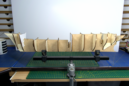

The bulkheads were a slightly slack on the keel but no problem to keep square until the glue set.

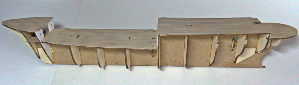

The deck planking is oversize for scale as mentioned by Bill-R. However, I don't have a means of reliably cutting them to size nor do I wish to purchase narrower planks.
I am ignoring the kit instructions for the plank shift and decided to use three plank shift which to me looks better. You will notice I am not depicting any nailing. I have experimented different methods but can't seem to get a realistic look to my eyes. In any case I have found the nailing hard to see in a lot of photos.
The caulking is black permanent marker down one edge and one end of the plank. I applied a sealer to the end grain before the marker to prevent the ink bleeding into the grain.
It looks great ! I wouldn't worry too much about the planking width. Not too many people are going to walk up to your model with a digital caliper to measure the width, much less know what the width is on the real ship to make the scale calculation except for people that are model builders on here. :D
Thanks. I agree with your sentiments.

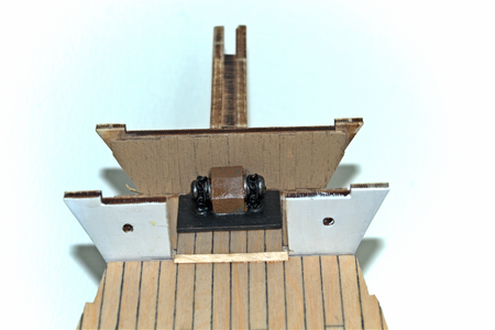

Some progress made. I pinched an idea from Bill-R and made a modification to the space under the foredeck. From drawings it appears the anchor winch is housed in there so I made representation of one using bits from my "odds'n'sods" box. Not too worried about accuracy as it will be mostly hidden, I just wanted something to fill the space.
