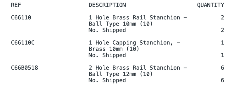

Where did you get your replacement stanchions?

I bought Billings Boats stantions from Cornwall Models. Understand you wanting to buy more local and would guess Billings is available. I have attached details of the reference numbers. Not sure if those are specific to Cornwall Models website but you can at least look up for reference. Note that the Capping Stantion worked out well for the rail at the stern. Look forward to seeing your progress.
Thanks, Keith. I'll check it out.

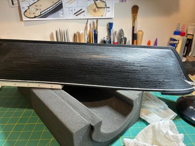

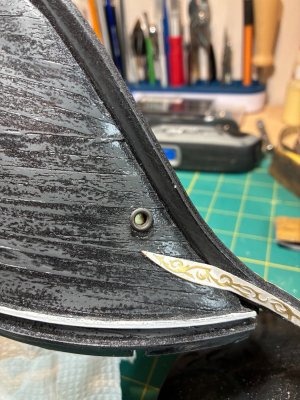

I got to get back to work on my Endurance. So, the plan was, move the port side anchor chain hole down towards the keel so its in line with the starboard side hole. Then, sand the hull and repaint the whole thing. I wasn't really happy with the hull paint job anyway. I repaired hole, put a bung in the old hole as needed, sanded it and touched it up with black paint.

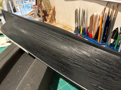

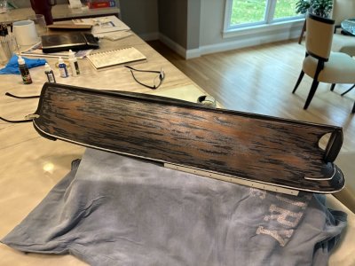

Like I said, I sanded the whole hull with the intent of repainting it. But now I have a couple of questions. One, how important is it to apply some type of sealer to the paint job? The last paint job I did I applied a satin lacquor and I feel like the hull wasn't matte looking enough. So I was thinking of maybe not applying a finish. Those more experienced than I who have models that have passed the test of time, what do you think? And if it is important, what do you recommend?
My other question regards a possible 'happy accident'. When I finish the model I plan to put it in a diorama showing the last days of the Endurance before it was crushed and sunk. So I always wanted the model to look more weathered, not very polished. But intentionally weathered, not just a sloppy job. I want to be proud of the model I built, so I want the weathering to always remind me that they weren't mistakes, and were instead attributed to skill (some skill) and patience. So after I sanded it, this is what I got.
I used 600 grit sandpaper. As usual, the pictures aren't great. You can see there are some spots where I got down almost to bare wood. The hull looks a lot more weathered and not as shiny, although the pictures look a bit shiny. Knowing my goal, any thoughts out there on what I should do?

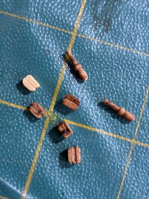

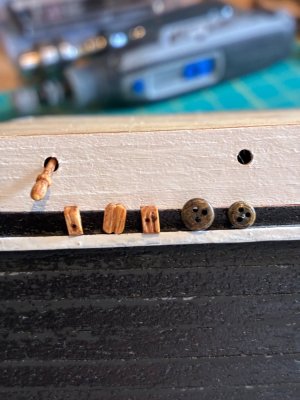

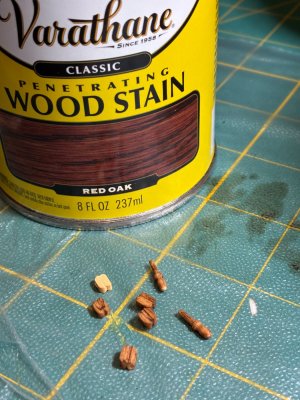

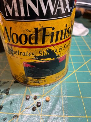

I was also going to buy some after market blocks and belay pins. I wanted black or dark brown for the standing rigging, and something darker than the bare wood for the running rigging and belay pins. Shipping prices are quite high, so I dug around and found some old stain and tested it on some pieces. Perfect is the enemy of good enough. I think I might go with the stains.
First off, Merry Christmas!!
View attachment 566367View attachment 566368View attachment 566369View attachment 566370
Hi, when doing the lifeboats I sanded down in some places to the wood. I was going to repaint but then left as they were to give the used/bashed/aged look and I am pretty happy with the outcome. As such having patches of bare timber works for me as well as areas where the paint is not so shiny. Looking forward to seeing your final diorama effect. PS Merry Christmas and best wishes for 2026. Kind Rgds Keith
View attachment 566371View attachment 566372
View attachment 566373View attachment 566374
I like the staining idea; I think I will do the same.
Thanks Keith! After sanding, do you put anything over the paint, like lacquer or something to protect it? OR do you think that's necessary?

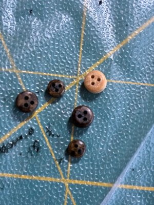

Another picture of my stained blocks and belay pins.
Kramer, the blocks and belay pins came out nicely! Magic Mike

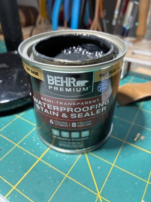

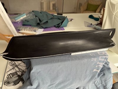

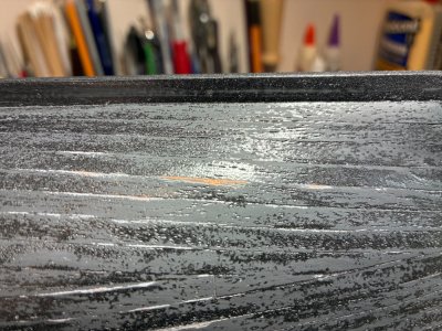

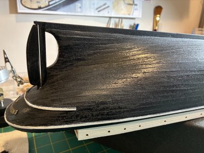

Well, been busy with my Endurance the last few weeks. So here's an update.

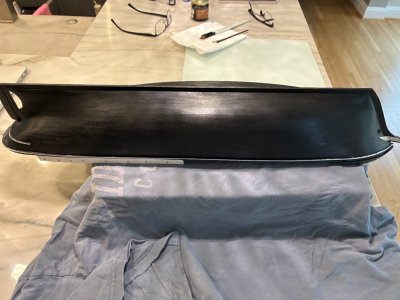

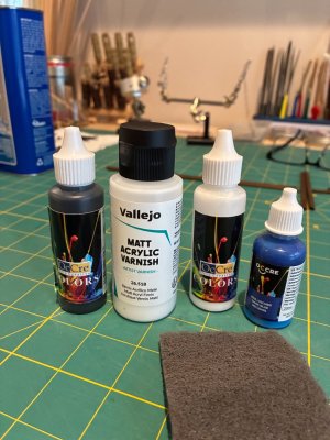

I redid the hull. I was not too happy with the paint job I did. So I did some research and came up with a plan. I sanded it down and filled in some gaps to make it smoother.
I used OcCre's paint and finished it off with matte acrylic varnish.
After 1 coat...
After 2 coats...
And after the third coat. I used very light coats of thinned out paint. The third coat was almost dry brushed. I applied it in very long strokes with light pressure.
Much happier with the hull. Not perfect, and I could have faired it some more, but there were a few spots that were not repairable. Overall, I'm very happy with the hull.

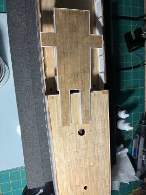

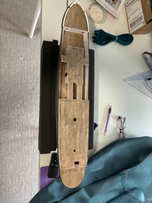

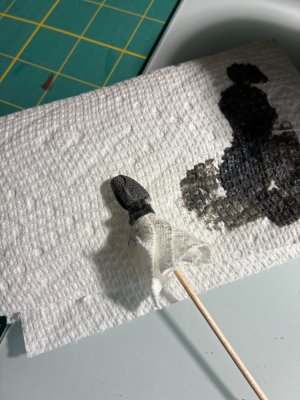

I also wasn't crazy about the look of the deck planking. I used a pencil to give it nails, trying to be more detailed and custom in my second build, but realized how out of scale it looked. I also wanted to weather the deck, and the whole ship really, to depict the last days of the Endurance before she went under.
I used some black wood stain on a piece of cotton cloth, and lightly brushed it on. Here's the contrast between the new and the old.
And the final deck. It looks a bit spotty and uneven. That bugged me at first, but I kind of like the uneveness, as it could depict spots on the deck where there'd be more wear, and a lot of it is going to be covered with deck furniture that will break it up.
