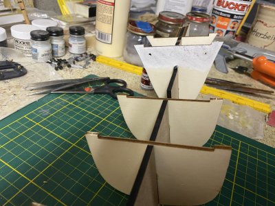

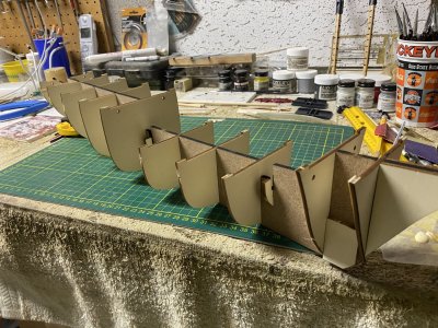

I have the keel and frames put together. no problems with this step. Everything fit together very well.

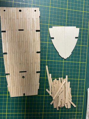

I have also worked on planking the decks. Again this step went smoothly.

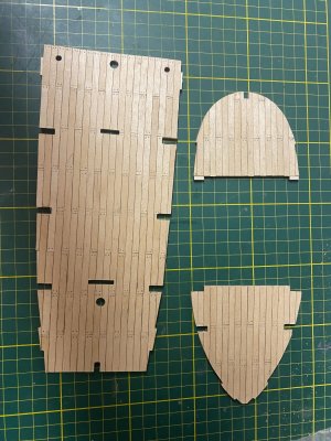

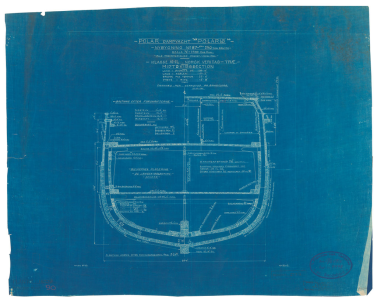

They really do look good! Assembly the deck planking looks to be a lot easier off the model. It hard to tell from the photos, but is there any rounding/camber of the decks? The below is the original blue print when she was built in Norway as Polaris and shows the little bit of rounding. The reason for the question is would a lot of rounding like on other ships cause the planking to separate when bent to match the cambered beams/bulkheads.

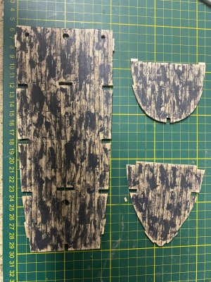

I have planked decks on and off ships I have built in the past. In my experience either way is about the same. The directions on this kit shows it being complete off the ship. This works for me because I'm weathering the decking and it's a lot easier to do this off the ship. But doing it off the ship also led me to trim more than I should have off, now I have some correcting to complete.

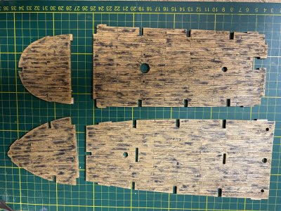

I'm trying a weathering technique I have never tried. I went over the decking with black paint, almost like a dry brush and then a good sanding. I tried a couple of different stains on some spare pieces and decided on the "Summer Oak" A couple of coats of satin finish to top it off.tempImageOUHXP5.jpg

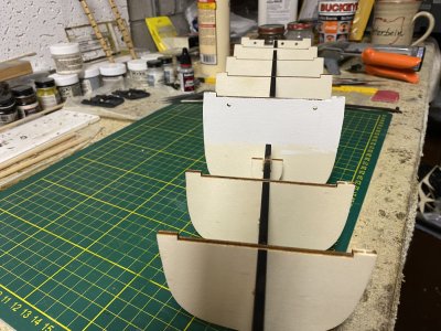

A couple oof the bulkheads that show need to be painted white.tempImageInXbUn.jpg
I"m weathering a I go along so I dried brushed some gray to dull it down a bittempImagekI2dly.jpg
After I get more of the ship complete I might try some washes or draw downs to add more weathering. This is all new to me so I learning as I go along.
