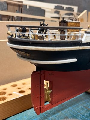

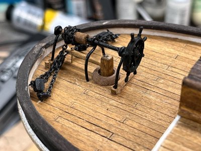

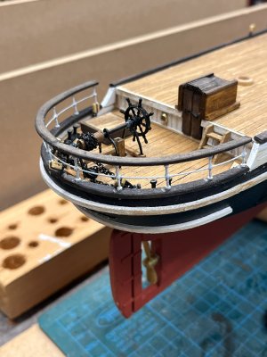

Modification 13: The stern steering on the supplied kit is enclosed and is very different to the historical pictures.

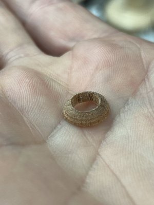

I recently started woodturning as a new hobby and used a somewhat oversized lathe to turn a "Donut" to fit round the top of the rudder post and used left overs from other kits to recreate the open steering gear.

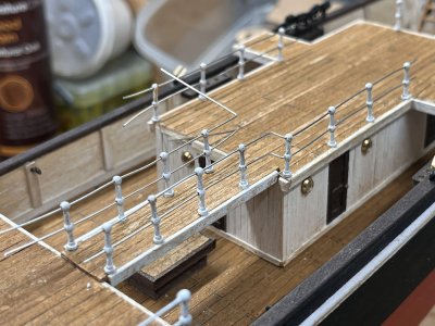

Modification 14: The top rail on the stern is wooden rather than wire.
I purchased replacement stantions as the supplied flat brass ones were poor. Using 0.5mm jewellery wire produced a more pleasing finish than using thread. The top rail was replaced with a wooden one to reflect the historic ship. This was the original rail provided with the kit; I had previously fashioned a duplicate pair to attach to the hull into which stantions were inserted. Also note that in images from the recent discovery of Endurance there is a gap between the end of the rail and the forward part of the hull.
Modification 15: Finally I purchased a 2 blade propellor to replace the supplied 3 blade version.

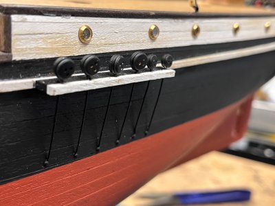

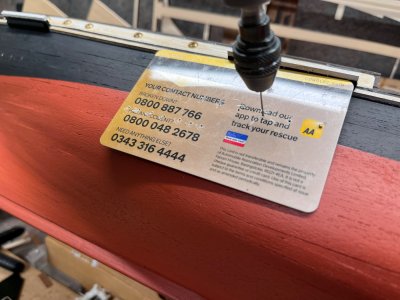

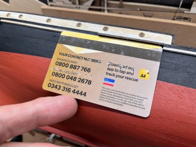

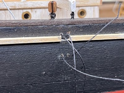

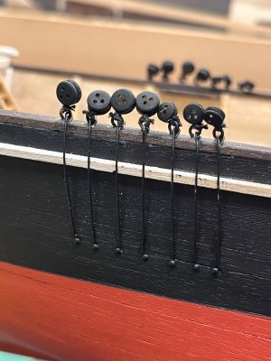

To drill the holes for the deadeye chains I used an old plastic card as a template to ensure consistent spacing.
The Occre instructions proposed using black thread. However I have used 0.5mm jewellery wire instead and used pins to hold the wire in place in the holes drilled using the template above.

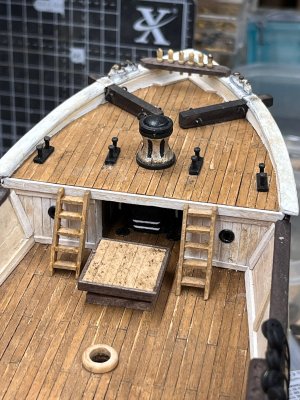

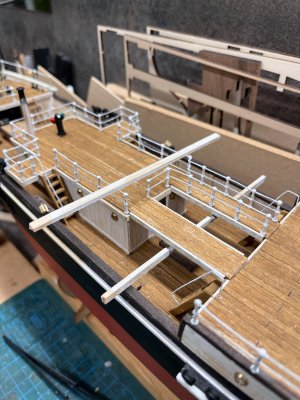

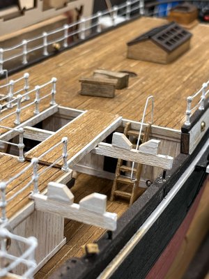

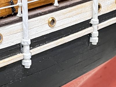

Work continued to complete the bow section. This included adding bollards, and ladders and drilling holes to install the stantions.

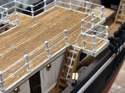

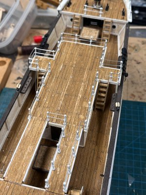

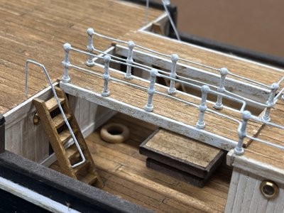

Modification 15: Additional purchased stantions to replace the Occre flat brass stantions and wire were added throughout the rest of the model.
I used historic photos an attempt to replicate the railings on Endurance. The Occre instructions have continuous railings as would be expected nowadays. However health & safety was not as it is now and there are areas where the railings do not appear on the actual Endurance.
Note that the left hand gangway has no handrails as per a historic image. I have also only dry fitted in this image and will not glue in place until I have installed the main mast as it would allow access to tie any running rigging.
One benefit of making wooden stairs meant I could easily create hand rails.

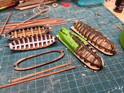

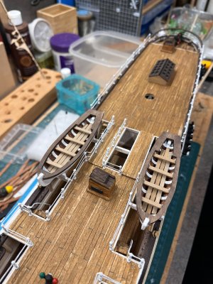

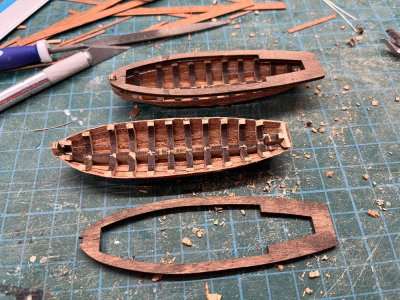

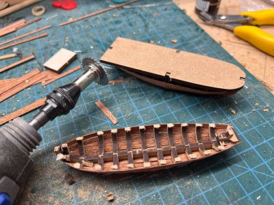

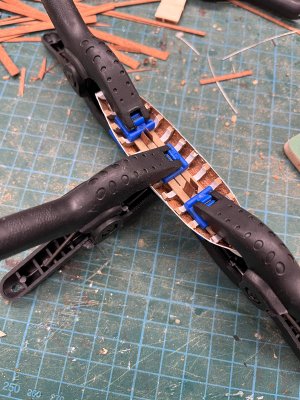

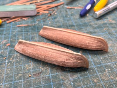

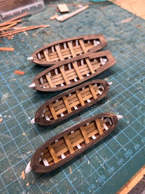

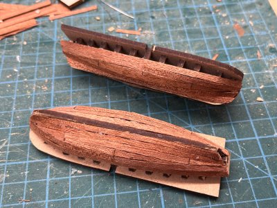

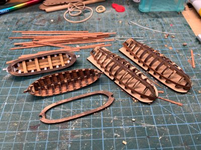

A while since I posted on my build log, probably too much procrastination over making the Endurance tenders/lifeboats. Well I finally knuckled down and completed all 4. I started on one to get the feel for the best approach and then ran a production line to complete the other 3. For the hull planking I cut the timbers length ways to make it easier to fit onto the small skeleton of the boats and used plenty of frog tape to hold planks in place while the glue dried.
Given the small size quite pleased with the initial hull layer with not too many gaps. A small amount of wood filler and some sanding was obviously required.

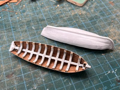

I bought a mini circular saw bit for my Dremel and that made cutting away the supporting frame much easier

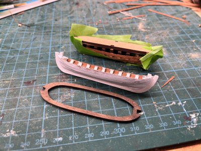

A touch of white paint and then added the flooring boards
Thankfully all done and not as tedious as expected ...

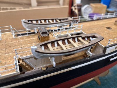

Modification 16: I added the boat cradles for the forward lifeboats as per the historical image.
This was quite a simple change using left over scraps of wood.
Not sure yet whether I will have the boats on the cradles or hanging off; a decision for another day.

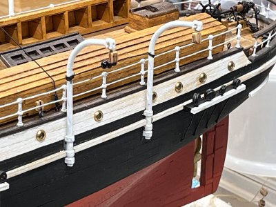

Since my last post I have been working on quite a few aspects of my Endurance build and been a bit tardy with my build log. It's a wet yucky day here in the UK so time for an update. From my last post I had an outstanding issue pondering how to a) attach the davits and b) whether the forward davits would face outwards as per the Occre model or whether to have the davits face inwards with the boats on their cradles. I call it pondering, my Admiral calls it procrastination.
Modification 16: Anyway decision made is to have the forward boats in their cradles and their corresponding davits inboard.
So how to attach, in particular to avoid them being knocked off?
Dealing with the forward davit pairs I snipped off the lugs which would not longer be required and rounded off with a small file. I drilled a couple of holes to each side of the davit and also cut away part of the white strake (apologies if that is not the correct terminology) so that the davit would lie flush against the hull for better adhesion. In addition to using PVA glue I used black thread to loop through the holes and tied around the davit and painted white to match the davit colour. I also drilled holes to allow for eyelets to be installed on the cradles to tie the boats down (See 2nd picture). With hindsight this would have been easier to do BEFORE I had installed the cradles.
For the rear davits again I cut away part of the white strake and drilled holes to accommodate the lugs on the davits and then glued with PVA glue. Note I did one side of the hull and allowed the glue to fully cure before doing the other side. Using these approaches the davits are pretty secure.

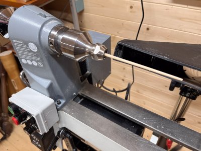

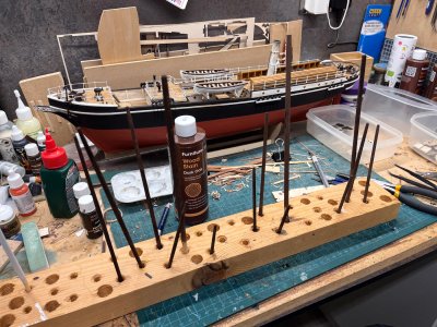

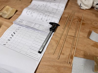

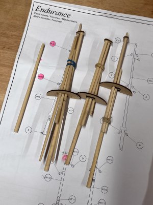

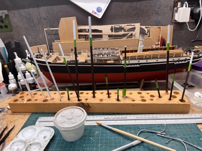

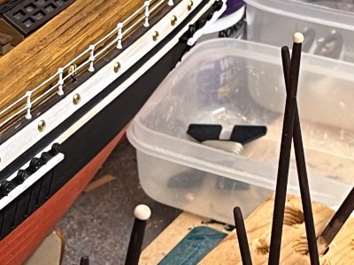

As an aside job to progressing the hull and deck fittings I have started preparatory work on the masts and spars. Fortunately I have access to a lathe (possibly a bit overkill for model making) and purchased a set of jaws to allow me to turn and sand smaller diameter dowels.
In addition I turned small beads for the top of the masts rather than using the supplied black beads
I had a production line of painting and used my favourite frog tape to produce clean lines of white

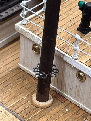

Modification 17: Looking at a number of historical images I have not seen rigging to points on the deck as per the Occre model. Historical images appear to show running rigging to pins on the mast. I have tried to emulate that by attaching eyelets to the masts. For the main mast this actually makes rigging easier as the pins are above the upper deck rather than the lower deck. For the purists the scale is not quite right but I think the effect will be more accurate than the Occre model.
After assembly of the masts a quick dry fit ...

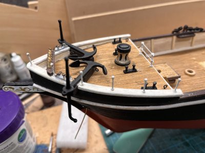

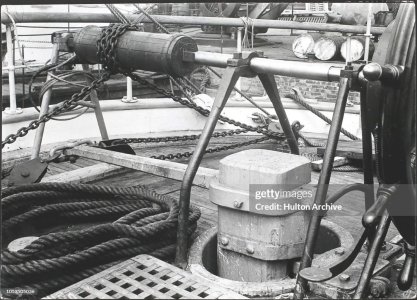

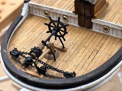

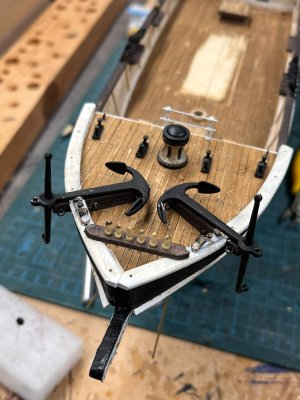

Modification 18: From images of the bow there appears to be a lifting mechanism to lift the stowed anchor from the deck. In the image below this is lying on the deck and there is a mount point to the right side of the bow.
I turned the mount point and glued triangular supports and used one of the brass rods to create the lift.
