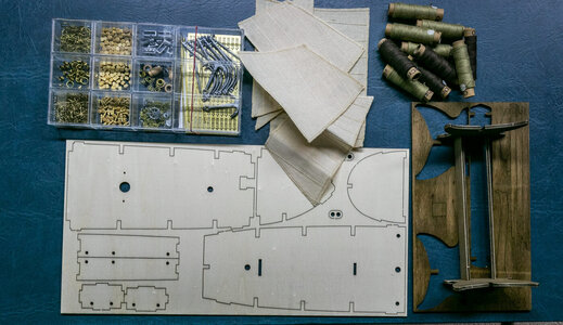

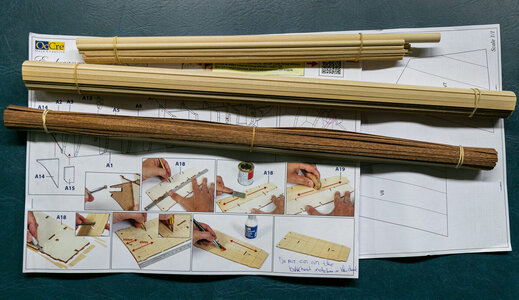

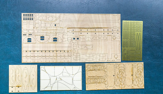

Hi all. I have started my next project (actually I started a few weeks age, but am just now starting a build log). I have selected the Endurance by OcCre. I chose this kit for a few reasons.
1. Reasonably priced
2. I wanted to try an OcCre kit
3. It is a historical exploration ship that will be going to my son's family for display. A warship might not have been as good for them.
To start, the materials in the kit seem to be of very good quality and quanity. I found a bit of overage on most standard wood strips which is always welcome. The pictorial instructions are typical OcCre and therefore quite good. The written instructions are also typical OcCre and therefore not so good. This could make this a challenge for a first build without doing some reading on basic techniques such as planking first. The laser cut pieces are quite cleanly cut and I liked the packaging of the materials. I purchased the kit with the sails and we'll see how those work out in a number of months. The kit includes a number of different sizes and colors of rigging thread. I am very certain that I will not be using these as they are very soft/stretchy and fuzzy. For today, here are some pictures of the contents of the model box.

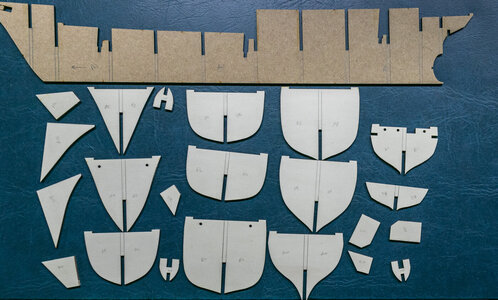

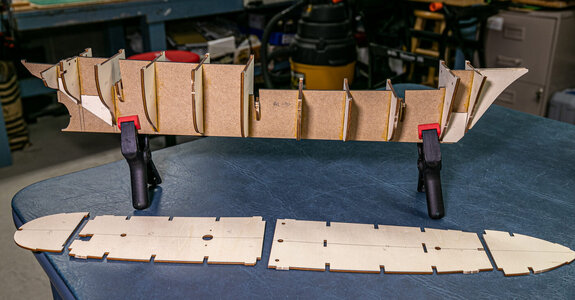

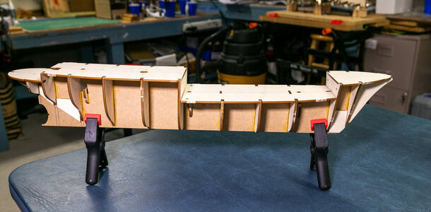

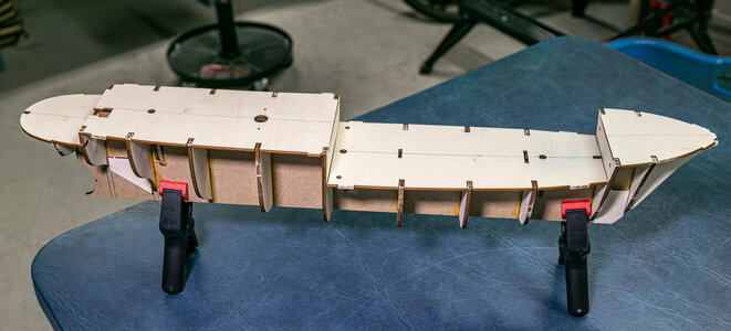

I got started with the bulkheads, false decks and backbone keel. The OcCre kit is well made and cut with the bulkheads requiring little to no adjustment to ensure they are placed at right angles. I would advise checking each bulkhead as you install, but they should go in easily. I used Titebond II to glue mine in place. I placed the decks on without gluing to make sure the fit was correct. Again, no issues. After the initial glue dried, I ran a bead of Titebond along each of the bulkhead/keel joints to add strength to the joint and added the additional parts to the keel for planks to attach to later. IMG_6619.jpgIMG_6620.jpg
You may note that I painted the exposed surfaces of three bulkheads white as per the instructions. I think 5 coats were required to get full coverage. The decks are still not glued at this point.

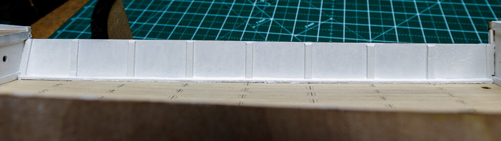

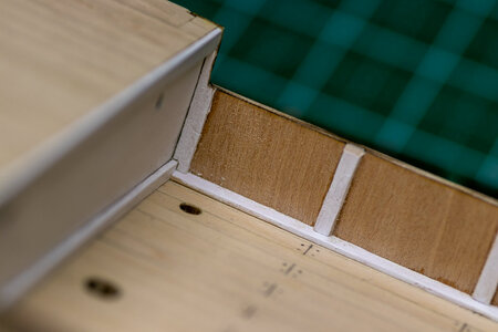

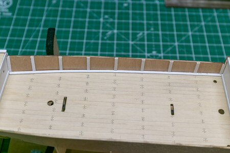

Slowly progressing on my build of the Endurance. I am proceeding with the bulwarks of the ship.

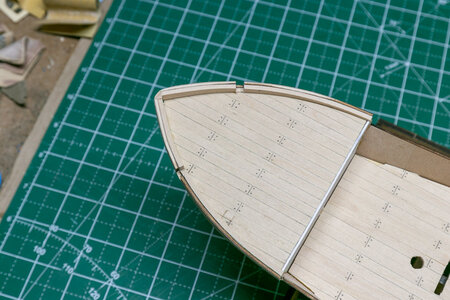

The bow
The pieces added to the insides of the midship bulwarks.

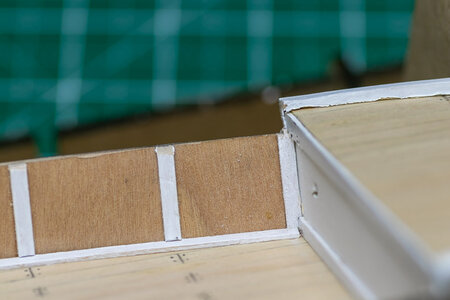

Details of the aft and fore bulkhead extension simulations.
I also have painted the insides of the bulkheads white. I am considering doing another 2-3 coats as the 5 or 6 I have already done just don't seem to be enough after stepping away from it for a few days.
