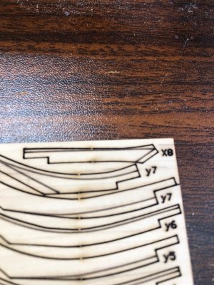

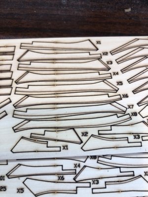

Struggling to find frame x8 parts for the hawse section. The only pieces I can find is nothing like the actual part which has a square end anyway.
See problem below.
Looks nothing like the YTube build video.
Can anyone throw some light on please.
Have looked through other builds on this site but just can get my head around this.
See problem below.

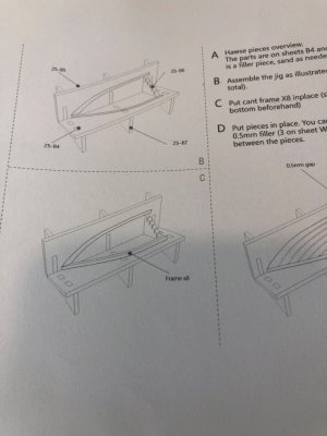

I have the same issue.
The answer from Victor ...
Greetings Mario
hello
The X8 frame consists of two single frames (as they are called in the instructions/video) on each side. So you don't glue them together. After assembling frames, you process them separately according to lasered lines. On the jig, you put only the half-frame build-up from three parts. And it will fit. I put some 0.5 mm spacer at the top end, as there is a thickness difference. There should be 10 parts in total for all 4 half-frames
hello
Thank you so much. Can’t sleep , keep thinking about this silly thing but you know what it’s like I’m sure.
It was the two frame thing I didn’t get.
Will have another look and please keep on this thread if I need more help.
So grateful.

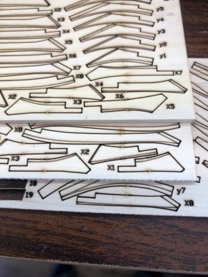

HiDragdonious.
Is this about right? See pic please below.
Just laid it down. No work done yet.
hi
According to the instructions, it should be a three-part half-frame. So use the other one. The side view plans have the dividing line wrong for this piece.
