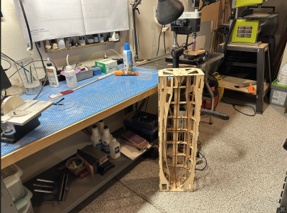

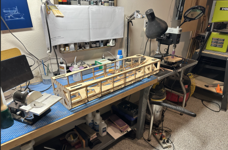

Ok, first off, this thing is going to be HUGE. Check out the jig.
The jig is 10"x 35". Typically the model itself is shorter than the jig, but the finished model is listed as 37", without the bowsprit. I am going to have to be creative in getting this on my relatively small bench space while I build, shape, and fit frames. I still don't know how I'm going to do it.
I've already started building value for this model with my wife to help her over the threshold of bringing it into the house and displaying it somewhere.
I knew it was big but I really should have laid down a tape measure in a couple of the spots I would want it.

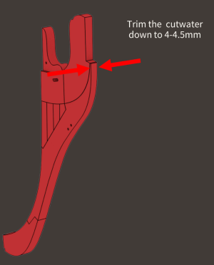

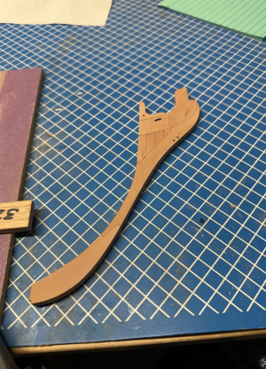

I got started on the stem with the tapered cutwater. This kit is laser cut which is a pain to clean but offers opportunities for joints that might be felted and tarred.I don't think the stem pieces are necessarily this way, but it adds a nice dimension to the assembly and brings out the complex pieces.
Of course I scraped and sanded all the loose ash before I joined the pieces. The browned portion of the burn still gives great grip after the ash and irregular wavy surface from the big, fast CO2 laser cutters are removed.

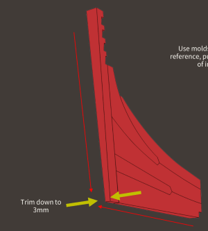

Next, I started the keel. Here's where I'm going to run into logistics problems. I have two long, thin panes of tempered glass I use to assemble things that need to be perfectly flat like keels and frames. This keel is the better part of that length.
Since even my largest MDF board coated with sandpaper is not a match for the length of the keel, I am finding that the card scraper is my new best bud.

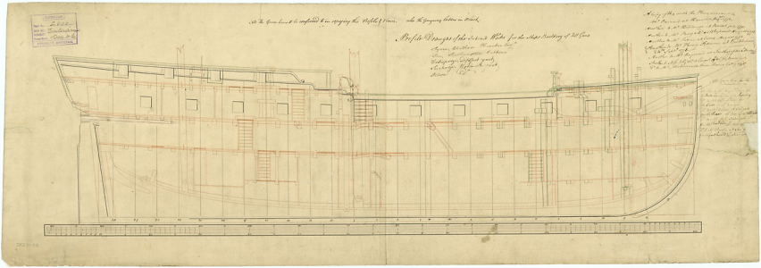

There are ten contemporary plans on the RMG site in low resolution and many of them are on the WikiCommons site in high resolution. The potential problem is that there are two designs, one as she was designed as a war ship and one as a hulked receiving/prison ship where she held captured men pressed into the navy before being assigned to fighting ships. The differences are obvious though so easy to spot..... no masts, no shot lockers, no wheel, a berthing deck in the hold and more on the hulk version. I have no doubt MD used these plans to come up with a very accurate kit, but wonder if they mixed the 1774 version with the 1790 conversion for some parts.
RMG: https://www.rmg.co.uk/collections/objects/search/Enterprize 1774 plans
Wiki: https://commons.wikimedia.org/w/index.php?title=Category:Ship_plans_of_the_Royal_Museums_Greenwich Click these for the high res versions. The first drawing, for example, is the hulked version and the last one which I only could find in low res is as a fighting ship. Even so you can see the differences.
