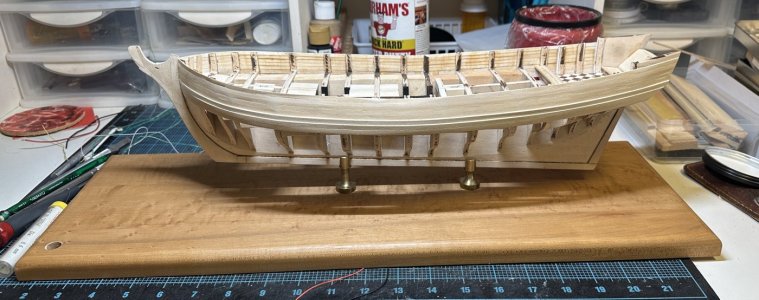

What a brilliant solution! If I am interpreting this setup correctly, the whole ship is a switch, just slide it back a little and break the contacts turning off the lights.View attachment 546702

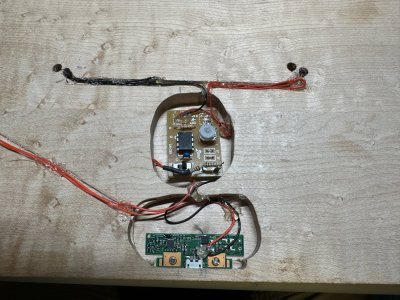

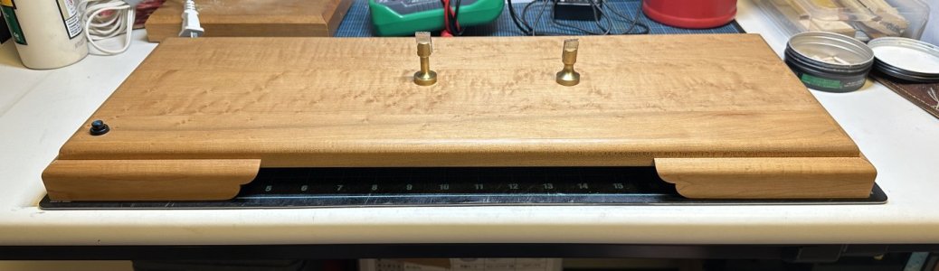

In order to wire the lighting for the ship before planking the hull, but still leaving the whole thing freely accessible as the rest of the build progresses, I am going to insert electrical contacts into the keel at the points where it rests in the pedestals. The pedestals themselves have leads soldered to the bases
One will connect to the positive side of the power supply, the other the negative side. The resistor and LEDs will be in series so wiring will be simple. I drilled holes for the leads next to the holes for the mounting screws.

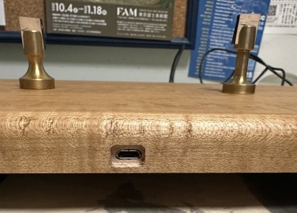

With everything set in place, this is how it looks. No sign of wiring and the ship doesn’t need to stay permanently attached to the base.

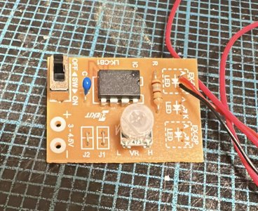

With the contacts installed and the ship resting in the pedestals, resistance across the whole setup is effectively nil. I’ll call it a win.
Just waiting for some resistors to show up in the mail so I can test the lighting properly.
Hi, Daniel! That’s a very interesting idea, but I don’t dare leave Fair American loose with as much rigging as she’ll carry. I’ll install a switch in the base, but the ship will be screwed down securely once the hull is complete..What a brilliant solution! If I am interpreting this setup correctly, the whole ship is a switch, just slide it back a little and break the contacts turning off the lights.
