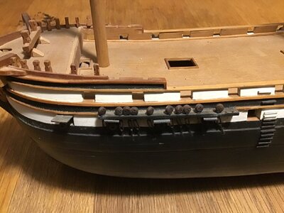

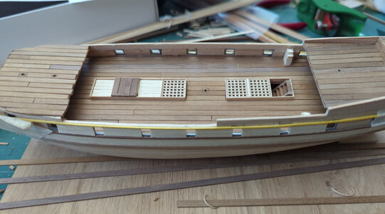

Hi all, I am very new to model ship building with sails and rigging, (I have a 1/35th scale HMS Bronington M1115 which I scratch built from a plan and a fibreglass hull back in 1989)

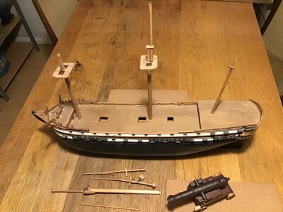

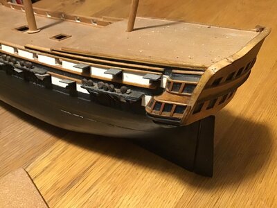

I was recently presented with a half finished model of the East India cargo ship the Farquharson, however, all I have is the hull with the decks fitted, 3 masts and a couple of photocopied sheet with some rigging diagrams.
Does anyone know if this ship was from a kit or where I can find out more details on this? I’ve tried the classic Google and Bing but get swamped with photos and information of other ships!
Are there any good suppliers for parts and the threads needed for the rigging, or is it standard cotton tread used on sewing machines?
As I mentioned, I’ve only just started in this (8 weeks to be exact) so it’s all a bit daunting at present! Any help or advice would be appreciated, also, are there any clubs where people can go to build these ships? (In Oxfordshire, UK)
Thank you, I’ve been going through a lot of the topics etc learning a lot of new tricks, and I’m amazed at all the skills for something so small and intricate in this online group!
David

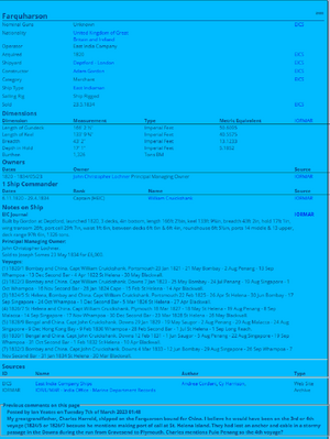

The east Indiamen merchant ship Farquharson was really existing and made seven voyages to China
Built by Gordon at Deptford, launched 1820, 3 decks, 4in bottom,
length 166ft 2½in, keel 133ft 9¾in, breadth 43ft 2in, hold 17ft 1in, wing transom 26ft, port cell 29ft 7in, waist 1ft 6in, between decks 6ft 6in & 6ft 4in, roundhouse 6ft 5½in, ports 14 middle & 13 upper, deck range 97ft 6in,
1326 tons.

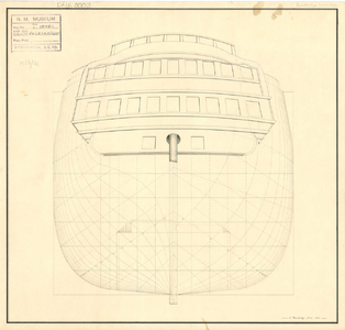

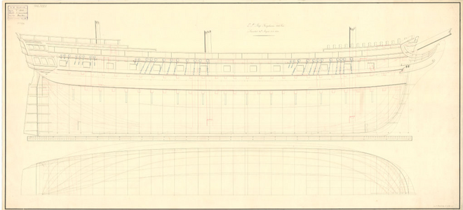

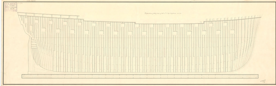

and maybe most important for you

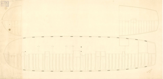

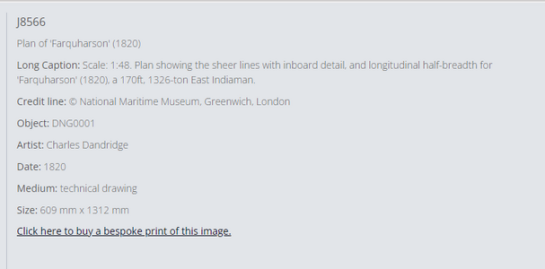

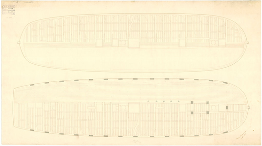

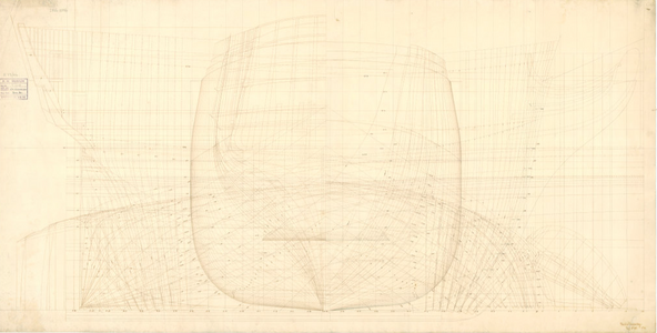

It seems, that the NMM has six original technical drawings of the ship
Folder​
6 plans of East Indiaman FARQUHARSON (1820). Catalogued on Access DNG0001 - DNG0006, now on Mimsy with the same DNG references (J. Michell, 6 November 2006).
Usually these drawings were done in scale 1:48 and copies in the same size can be ordered from the NMM
f.e. one sheet has the size Sheet: 518 mm x 1172 mm
These are the six abvailable drawings of the original ship
Sorry for the delay in responding, thank you all for the welcome and information, gives me a lot to work through! :)
Are there suppliers of components for 1/96th scale sailing ships? I’ve found several which caters for modern vessels, I know this is probably cheating haha, but my skills and eyesight are not what they used to be!
Thanks again….
There are many suppliers that you can get components from. Many of them are sponsors of our site here. Many different parts such as blocks, cannons, rigging line, cleats and even resin ovens are available at Drydock Models. Blocks are available at HiS models and Model Expo and many others. Rigging line is available at Ropes of Scale. I'm sorry that I did not list them all, but we have too many for me to remember them all. :) Just go to the initial forums page and look along the left hand border for the list of merchants. :)

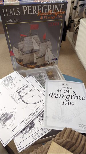

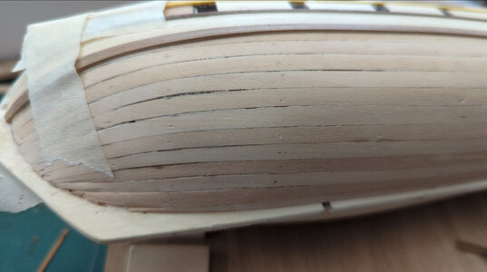

This is the ship I’d been given after starting the HMS Peregrine kit which I’d also received as a present.
I’d never made a model like this, but after spending a couple of days reading a lot of the articles on the forums here about planking the frame, I felt confident enough to have a go…I was then given this hull in the state seen here, but no information on the mast and rigging setup. I think I’ll try and finish the HMS Peregrine kit first….. PS the cannon was one I made in 1976 at school, when they still had a metal work department…and used to “fire” cut up firework’s 3E50E93A-17DC-4634-9303-14A156C07627.jpeg71F2280D-8581-4890-89E5-63AE22164313.jpeg36B36C98-9B61-4189-97BE-F8A5704264F0.jpeg71BEF4ED-D18F-4E8F-A563-387B9F6D29E8.jpeg30F61F47-D902-4A08-A81B-07954CD0F997.jpeg70464806-7F20-458C-AE41-D9272A42BFCF.jpegE103CB13-128A-4281-AA71-9087C21521A2.jpeg0747EB19-3EA4-477B-AEA5-652249ED38B9.jpeg
