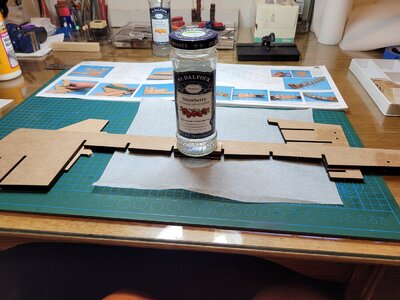

Opened the box, plans look good, instruction book looks good as well. The wood needs comment. The planks look fine,to be fair they look good.. almost all of the structure is MDF in 3mm 4mm and 6mm, thats all the keel, bulkheads, and deck sub structure.I have mixed feelings about this, as it is very accurate, flat and stable, goes together excellently....but breathing in the sawdust probably isn't the best plan. It is clearly a cost saving measure, the only parts which are not MDF are the planks, the deck furniture and cabin (very thin 1mm ply) and masts of course. So overall it all looks good and capable of making a good model provided you dont mind the MDF. I dont want to be nasty but it is just as well they cant make planks out of MDF, but maybe that's a cheap shot.

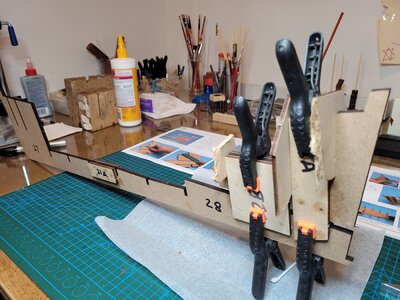

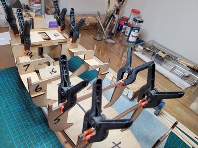

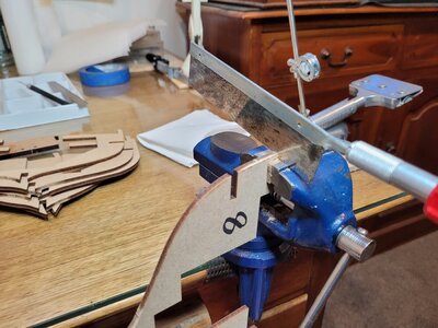

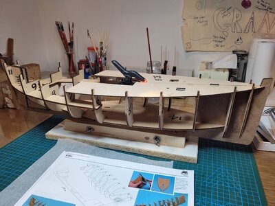

Bulkheads glued in, deck and bilge parts dry in place to locate the bulkheads correctly. The frame is somewhat over engineered for a static model because of the RC provision I guess

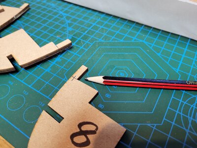

Where is bulkhead 10 do I hear you say..? well it is on the desk having it's portside tab reglued as i knocked it off...what was I saying just above..?

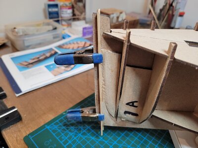

Faired and fitted the stern and bow fairing pieces. I nearly made a very silly mistake but caught myself in time...the stem and the stern on this boat are both vertical and at this early stage you have to be careful not to get the ends mixed up. I started off intending to put the four bow pieces at the stern... duh.

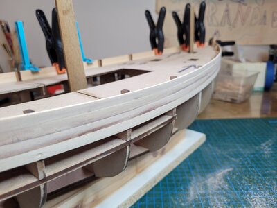

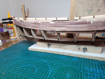

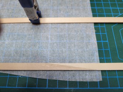

The planks are provided at 600mm and the run of a plank is about 780mm so you have to join them. Lots of complaints about this but get over it.. the real boat would have had 20ft timbers if it was lucky which would see about 4 sticks to every run. Yeah I know POB isnt correct to that degree but 1 join is not an issue IMHO. Planking is good wood and joins well. This is only inner planking. I am going for a bit of authenticity as in Chris Watton's introduction where he emphasises that the real boats are painted top and bottom and the example model is only "clear" to show materials used . So if I am painting I might only have to do 1 layer of planks...woohoo...
Remainder of keel setup... a bit complex aft because of the need to provide for prop shaft if going RC which I am not. So far these parts fit perfectly. The laser cutting on the MDF keel and bulkhead parts is noticeably finer than my previous Amati build.
Chris Watton says that the provision of MDF has nothing to do with economy. It is a response to issues with plywood quality, most importantly the tolerance on thickness. Using mdf allows the fitting to be much more precise and predictable, and variations of a few tenths of a mm in thickness make accurate laser cutting impossible. Best to look it up, I am not fully quoting his whole argument. I just finished Amati Lady Nelson hull and I thought the MDF part fitup was awesome. I had to learn how to fair it without damaging the edges though. Not hard to do.

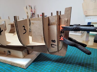

I really like to spot glue a piece of 2 x 3mm to help getting the planks to land in a nice straight line at the stem. It just snaps off.
Nice model. It was on my short list when I bought Terror just recently, so I am watching with interest. Are you making a kind of false rabbit with that temp piece then?
No..it just provides a straight edge to bring your plank ends level more easily and a ledge to stop the clamps springing off whjen trying to clamp the ends on their slope.
