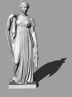

If you speak about your models, your speak about virtual templates ? To cut them in pieces and find the positions you do in Rhino as well ?
Yes something like that. Here's a simple example. I needed to make a taffrail sculpture for the Royal Caroline yacht. I found a suitable figure on the Internet (this is a scanned real sculpture) and changed it a little.
