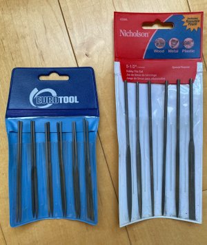

Over the last six months I’ve bought two different sets of files for modelling.
Both of these were garbage. From Amazon.
Can someone please give me the make of some excellent files? I believe that you get what you pay for so my purchases to date have proven that. Thanks.

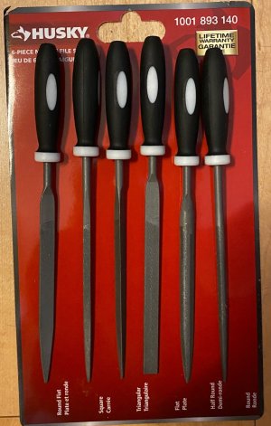

Just was passing by my local Home Depot. Peaked up set of very decent high quality needle files. $10 Canadian. No need buying Corradi Pferd to last forever. Files are disposable tool. When it was worn out, throw it away and buy a new one.
