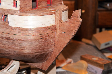

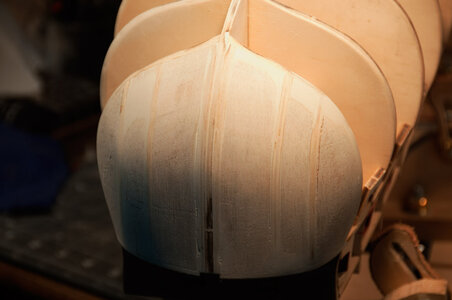

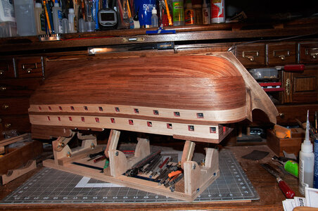

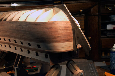

Balsa works great! And easy to shape! Reconsider.Nuestra_197.jpgNuestra_196.jpgNuestra_252.jpgNuestra_263.jpgNuestra_289.jpg

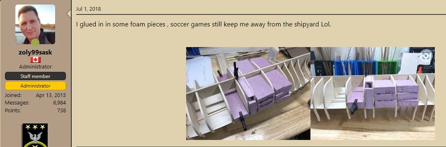

any of the soft woods like Balsa, basswood, willow, poplar, Alaskan cedar, pine even dense foam board
zoltan used dense foam board

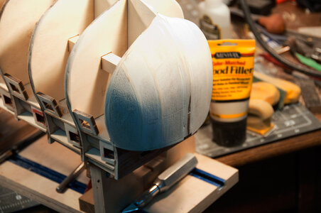

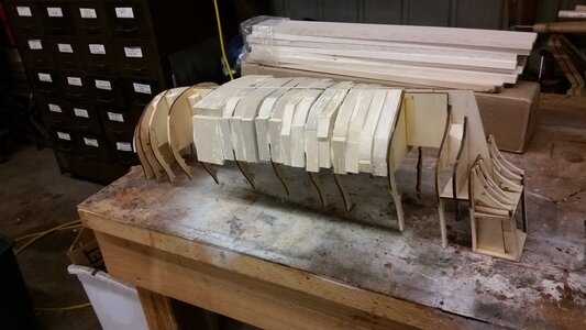

Gluing in balsa blocks. It looks messy but it gets better.
Rough sanded to shape. Filler is used to fill low spots and then sanded. Then planking starts.

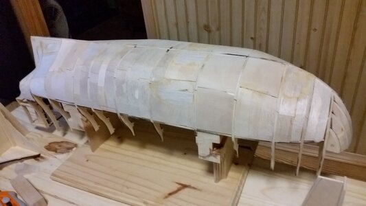

Hull after first planking and fine sanded. Curves are uniform with no hard bends that betray the location of any bulkheads and there are no flat spots.
