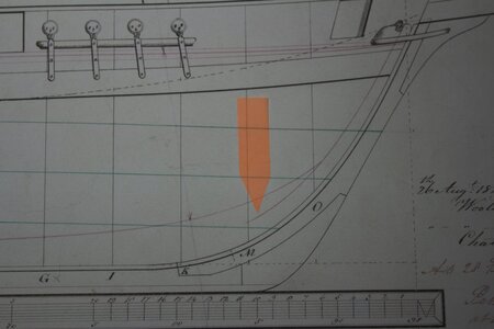

The picture below shows the stem detail….. Is this the upper limit of the deadwood?

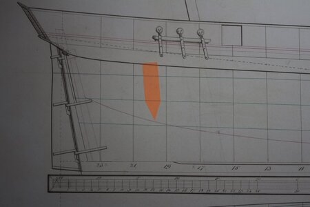

This line progresses through the midships (see below)

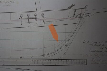

Note the arrow head to the left of the pointer, it drops through from the center line of the mast above, I assume this is the position of the mast step.

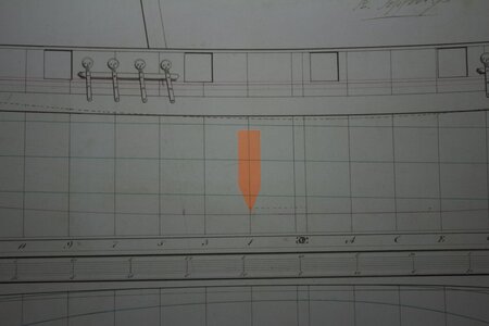

Finally at the stern…...
What is the line in the photo below? How does the Gripe fit into the keel/false keel?

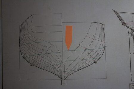

I have assumed that the 3 green horizontal lines on the shear are the water lines. On the section the green lines are also marked, if these are aligned does that give the relative height above the keel for the different frames to step the deadwood accordingly?
