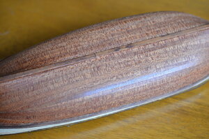

Watch out when doing the second planking on the Occre kits. They show you the Extremely thin planks laid out side by side to apply the contact cement, I tried it and found out that the strips rip when pulling off the board they used to lay out the strips. I then changed the procedure and now apply the contact cement to each strip individually and hang them vertically with ample space between the strips. Good luck on your build. Have you considered lights in and on your model? If so email me as I have done this and they look great. The circuits are a bit tricky but as I said email me and I will help out.

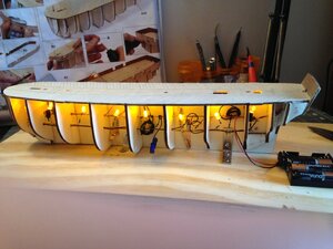

Ted - I have the Occre Terror for my next build. I appreciate a description of the lighting circuits. I've never used illumination. Thanx jbeerman@me.com
Hi k,
I am sort of busy tonight but will send as much info as I can tomorrow.
I will also try to add some pictures. Never added pics before it could be a good challenge.
I hope you haven’t put the bulwarks on the keel yet as it will make the adding of lights a bit more tedious.
Hi K,
I will send more info on the flickering lights but need to know your knowledge level of electrical theory.
If you have no knowledge then I will give you a step by step method. If you are knowledgeable on electrical theory I will send the web sight for a supplier of the LEDs and resistors along with what I did to the model to accommodate the wiring, including the lanterns on deck which I have made myself and look pretty good.
Ted
