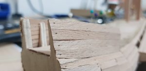

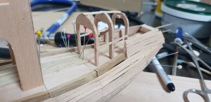

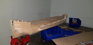

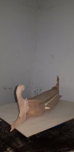

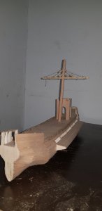

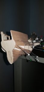

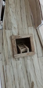

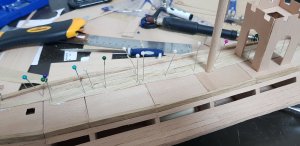

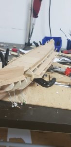

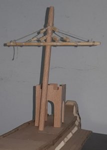

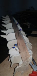

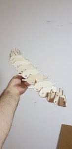

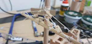

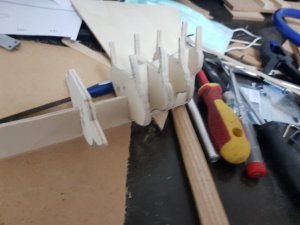

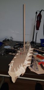

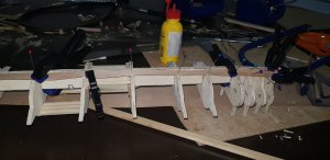

Hello, this is the first time I'm building a model ship. I decided to build one from scratch since I don't have anywhere to buy kits in my country.
I used plywood for bulkheads and veneer for hull planking.
I'm open to critic and suggestions, don't be harsh, it is my first time :D
G'day modelibrodova
Welcome to SOS. Thank you for sharing your first time adventure in model ship building with us.
Firstly, you are doing a great job, but there are some pointer which might help you. This is far from being a criticism, but rather a guide.
The mask and yards. It would look better if you tapered the mask from thick at the base to tin at the top. Like wise with the yards. They should be tapered from tin at the end and thicker
at the middle.
Your mask as you can see is the same as from the base to to the tip and the horizontal yard is also the same thickness.
Now compare to this photo
You can see that the mask is tapered from the base and the tips. Also the horizontal yard is also tapered.
Hope this will show you the correct ways and I hope that you take my advice to you, as not as a criticism, but only as a friendly advice.

Thank you for your advice Greg, it is very helpful, I appreciate it. I love to learn from people who have more experience in this than me, hope I will be able to on day give advices to others. And thank you for your welcome also ;)
