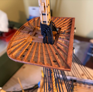

One comment: I just setup the shrouds on my Revenge. Few tricks I found useful:
a. Serving the portion of the rope that will be attached to the mast. Served ropes are very hard and does not compress. So, when you start laying then on top of each other they stack very nicely. Non-served rope compress irregularly and does not look as nice.
b: You can see that the shrouds are attached is a very specific order. NOTE (after editing): The first pair on one side (starport), the next on the opposite side (port) of the ship, and so on. The first shroud is the one toward the bow. You keep alternating until you are done. You will end up with 4-5 pairs of shrouds per side (or whatever you need).
c: Yes, attach a pair of shrouds together. Fold the rope in two and cut to length (in fact cut 2-3 inches longer at each end), you now have 2-shrouds. At the fold, tie the rope while testing on the masts - to form the loop. As you can see above, tie the loop very closely. Once you have tested one, you can do all the others on the table and then stack them together on the mast (if you have not setup the upper mast) -- otherwise, you will need to tie on the ship (a little harder).

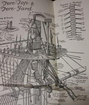

I am not sure if this was universal, I would not be surprised if there were exceptions. Longridge shows the starboard pair of shrouds going on first as seen in his drawing below in The Anatomy of Nelson's Ships and James Lees, in The Masting and Rigging of English Ships of War, states on page 41 that the shrouds were put on the masthead, the first pair being the forward starboard one. What I have seen for the general order of dressing is that for the lower masts the pendants of the tackles went on first, followed by the shrouds, swifters if there is an odd number of shrouds, stay, and finally preventer stay if there is one. On English ships after 1810 the preventer stay went on before the stay.

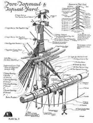

Thanks for this, am OK with shrouds at middle mast its the stays on the top of the masts that is the problem
The diagram posted by Uwek shows how skilled the sailors were being able to rig these masts - awesome complexity in the masts, and all done by hand!.

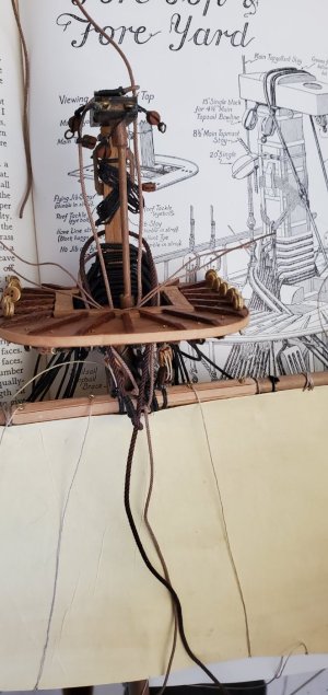

In my exuberance I built the entire mast before I looped the shrouds.
I’m contemplating cutting the mast so I can serve the shrouds off the model then loop them. I’m worried about rejoining the sections .i think that if I drill a hole in each end and insert support pin to reglue the masts together should work and create a solid bond. Any thoughts?
Break out the alcohol and undo all the parts on the mast that are in the way. Redos are a big part of this hobby. Rigging off the boat is the way to go if you possibly can.
