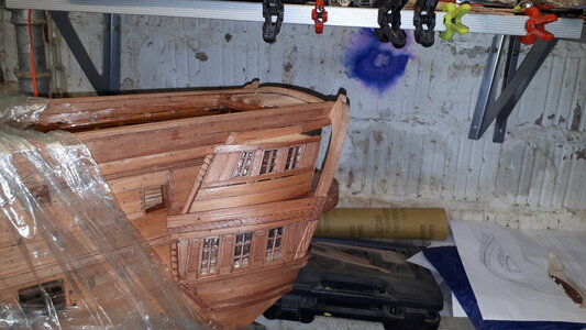

In order to "install" glas into the small windows at the stern of my HMS Granado I was think about to fill the window frames with some fluid glas.
I know and can remember, that some of you used such material. But I can not find some in the building logs....
So therefore on a faster way my question:
Which fluids did you use and with which experience?
Maybe you could show us also the results..... if possible
BTW:
the areas to be filled are appr. 0,4 * 0,5cm - the material of the window frames is boxwood -
the backside has to be sanded down, that only the sprouts of the window stay, so that space between the frame and sprouts will be free
I am also open for all possible alternatives to imitate the glas windows ......

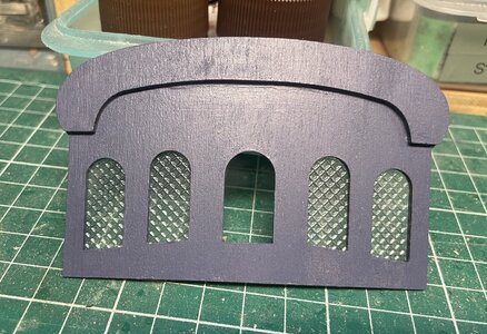

Here’s something I just came up with for the stern windows of my Endeavour build. Used Food Saver brand vacuum freezer bags. Have a nice small diamond pattern moulded into them. Thought it looked a little like leaded window panes.

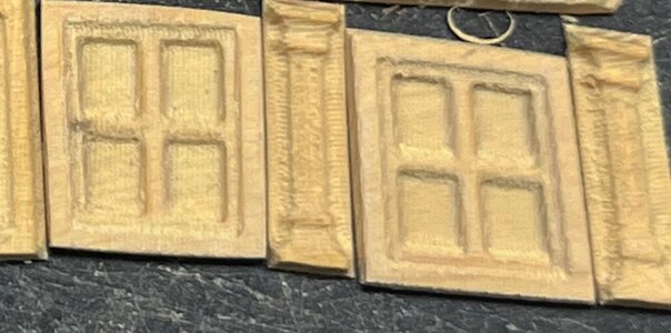

One thing I found wanting with glue, Mod Podge or liquids was the meniscus around the edges. But at the same time it added a little texture which maybe makes the glass look older. The jury is still is still out for me. I think the fact that these things are all PVA glue is a plus because it holds all the pieces together.
