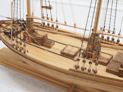

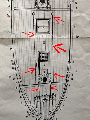

Hi Members
In the attachment the anchor chains of the Flying Fish are nicely stretched between the hawsehole and the capstan unit.My question is don't they need a fixation facility on the deck during sailing specially at stormy weather . Are they gathered together?Nothing is mentioned in the reference booklet and on the plans.
Thanks in advance for your responses and wish you All a nice and a healthy week
Hi Korsan!
Was the chain placed that far across the deck? That also occupied me during construction.

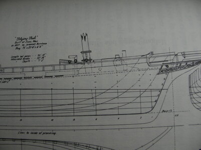

Construction drawing of the Flying Fish from the book "The American Fishing Schooners, Howard Chapelle". No raised foredeck. It is somewhat different from Corel's drawings.

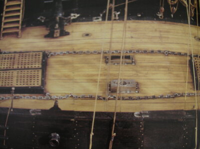

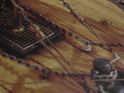

But such long chain ways up to the storage area really existed. Images excerpts from "Modeles Historiques, Editions Ancre", La Toulonnaise 1823. The chains were attached to rings.

I guess the chains would be secured with some rope at eyebolts and ring in regular distance on the deck, like shown on the photo from Thomas of the La Toulonnaise

I think Corel took a lot of liberties with the design of the Flying Fish. We in Europe have limited access to the museums of American fishing schooners. There is also limited access to notable people with relavant knowledge such as Howard Chapelle or Erik Ronnberg.
And so the Flying Fish is replicated from the Corel construction kit.

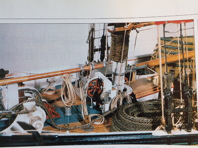

Photo: chasse-marée, number 152, page 56.
Achor chains, according to Chapelle, only existed in harbor service and they were short and kept in a chain box on deck. Seen here under the fore gaff, next to the companionway to starboard. Otherwise there were anchor cables to the left and right of the fore mast.

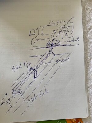

Thank you very much for the bundle of information and your encouragement regarding shipbuilding -codex .The chain in box on the photo you send may also be additional chaint to lenghten the existing one or as reserve. Any way ,by my model I will add the parts shown in the attachment for the loosely and free stretched drawn anchor chains,in order to protect the deck planking and the slighly raised wooden deck edge before the capstan. I will post the photo when finished.

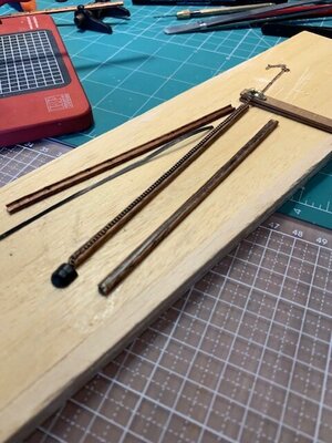

End product for the Flying Fish
The anchor chain organizing arrangment finished looks like now as in the attachment. I want to add 1 more ring to the woodpart to eliminate sliding completely during sailing
Metal strip in the attachment 100% brass ,which I blackened in diluted selenious acid.
