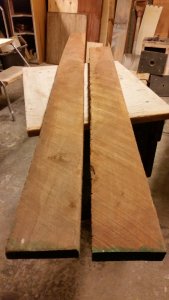

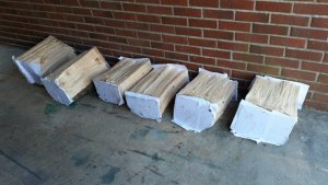

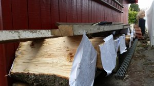

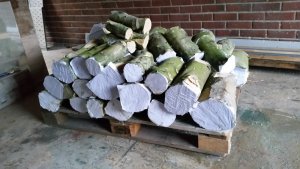

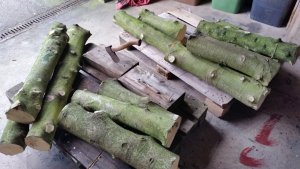

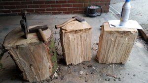

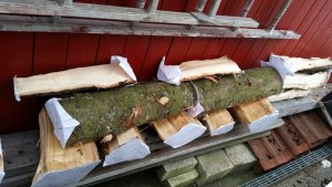

division of wood for drying.

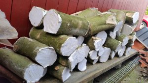

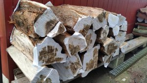

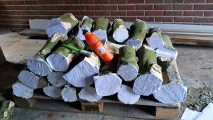

paste on paper so that the tree does not crack.

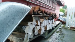

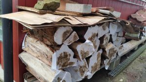

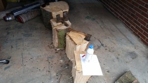

laid out for drying.

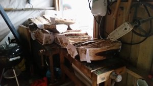

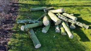

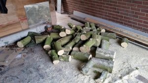

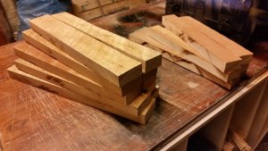

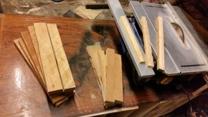

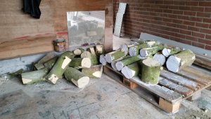

a little more I garage.

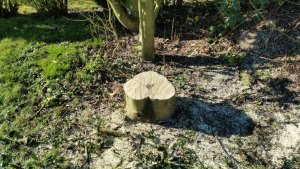

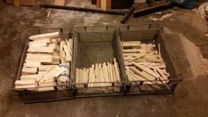

prepared for construction, the box to the left holly, the two to the right are birch.

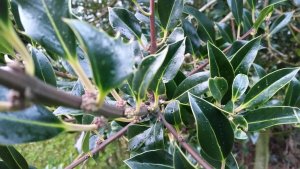

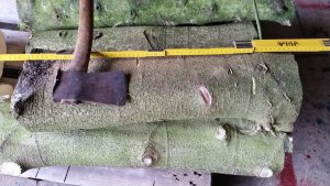

holly.

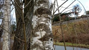

Birch.
from the left, plum, birch, christian. holly
The variety that lies to dry is, birch, pine, spurse.
for the summer I will cut the wood to a more appropriate size and make sure it is dry enough for further use.

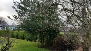

Brian, I got the trebles from a farmer I know, but it's quite easy to get the birch, pine, spurse here in the district.
Before spring I will cut a big holly tree my neighbor has promised me

Hello Norway,
That is a brilliant idea and harvesting your own timber will make your hobby that much more affordable. I understand that the paper pasted to the ends it to prevent the wood from drying out too quickly at the ends in relationship to its center. Once the timber is prepared for drying, how long do you let it sit?
Ray
Dec 3, 2018
2,146
538

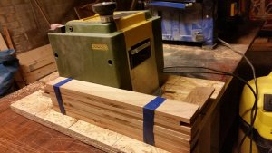

Outdoor warehouse finished may, garage warehouse august, then i will adapt the timer to 4x7 cm to fit in my proxxon thickener,
Hope it is dry after one years drying

Fantastic! I harvest hickory for bows, good to see you covered the ends for drying, many folks don't know to do that. I usually use latex paint or trappers wax. I usually check the birch trees for Fungus, it burns very slow and is great mosquito repellent for when we have cook outs in the summer.

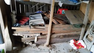

Totally off topic, but what is the car barely visible in the sixth picture? It looks interesting. Was the teak formerly outdoor furniture? I found a teak chair in the trash, but I am 400 miles from home right now.
Dec 3, 2018
2,146
538
It is doors gates windows, lots of stuf made of teak

Tnx to all the members out there for all the likes in my tread, nekst time will be in may/jun for this tread,
mayby some photos when i hawe cut down the HOLLY-tree shovn in the latest photo in this tread

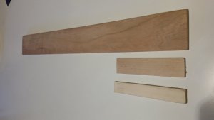

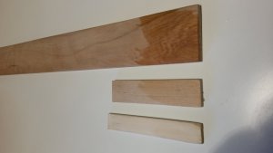

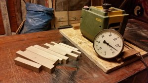

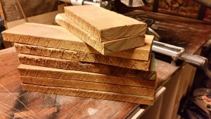

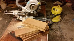

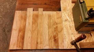

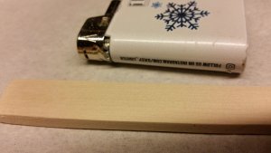

Cherry plank for about 18 dollars.
Adjusts in length.
Adjusts to width.
Adjusts to height.
Done.

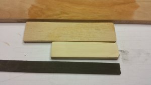

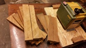

Adjusted a some birch.
Cherry, birch, holly.
Cherry, birch, holly. and blask stained holly.

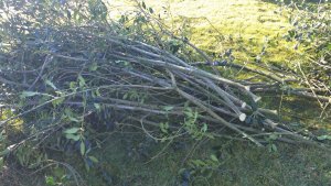

Mayby 50%, a lot goes away in the form of branches, bark, endcutts, it gets exciting to see in a year's time
