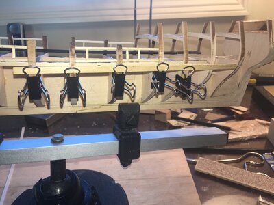

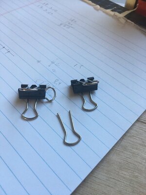

Was researching planking on Youtube and saw how he used clips to hold planks in place. You all probably already knew that, but just in case….
Here is what I did to replicate the tool. Second picture was my doing a dry run on using it
The clips are petite size
