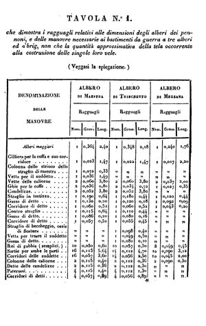

Hi, see a little bit on this table
Thank you, but how to read this ? Im loking for Straglio di maestra or contro straglio ?
