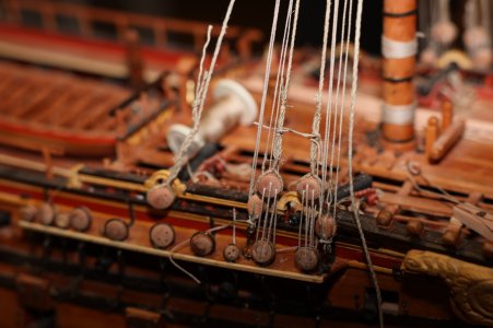

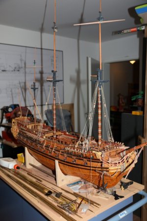

I have spent the last few months working on many details to finally finish the hull. The only thing missing are the anchors, brass has already been ordered. A lot of things were mass-produced: fastening devices on the hull for the shrouds, rings, cleats, belaying nails, railings, etc.
A few deadeys seem twisted around the wrong way, and didn't they normally have the long groove from hole leading up to ease the strain on rope going thru?

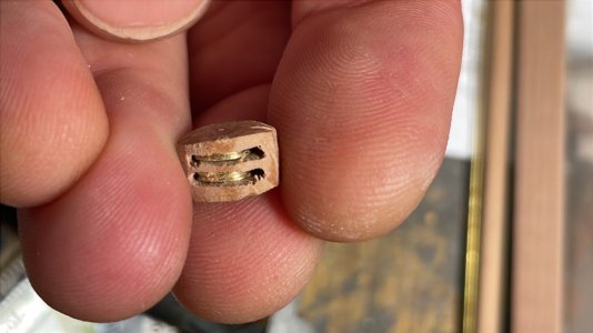

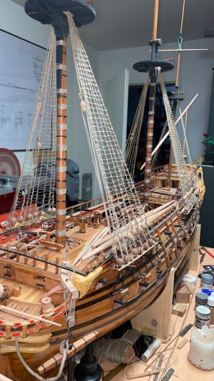

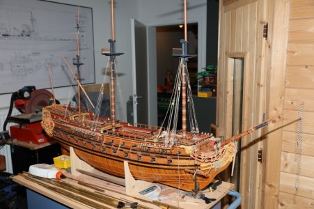

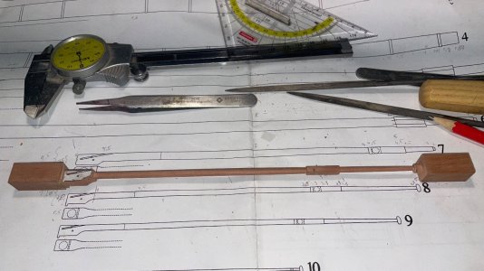

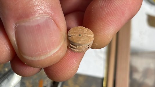

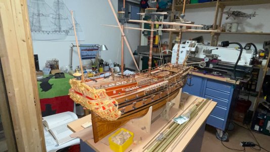

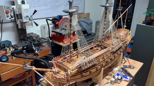

Hello, I'm posting again after a long time. The hull has been completely finished in the last nine months. I made all the masts and yards on the lathe/milling machine. And now I'm entering a new phase: the rigging. I'm making all the blocks myself from pear wood; that takes time, but it's worth it. The ship should be beautiful, not just finished quickly. I'd be happy to show you some recent pictures.
Thanks for sharing the pictures of how you are making and progressing with the yards, blocks and deadeyes!
Intricate and superb work.

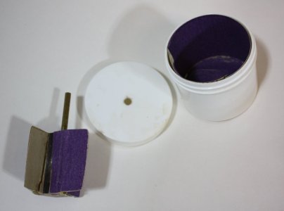

Making the blocks with the sheaves is to be commended, it is a lot of work. How do you round off the block edges? If you are doing it by hand, a homemade sanding tumbler works really well and is super fast. Throw in the blocks, screw the cover on and spin with an electric hand drill.
