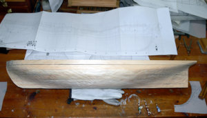

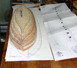

Began to build a model of the French 8 pounder frigate La castor, built in Quebec City at the Royal Dockyard, by R.N. Lavasseur, master shipwright. I am basing it on the plan for Le Renommee, of 1744, of the same class. I am building her in the combination method, lower hull bread and butter, upper hull plank on rib. It is a method that I enjoy working in as I do not show the lower hull construction.

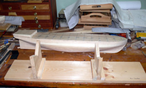

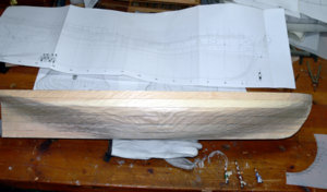

Today I had my apprentice here for his lesson, and afterwards, constructed the building cradle for holding the hull while working on it.

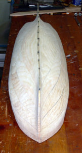

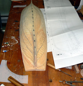

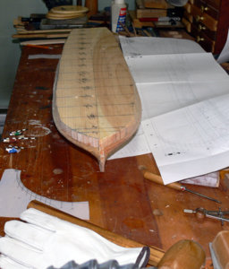

To answer Uwek's question, I cut out card stock with the hull contour at each rib and hold them against the hull to check for accuracy and adjust as necessary. Photo of stations attached.
Very nice work, I love to see the hulls being carved, its such a hands on experience, I might have missed it but what sort of wood are you carving from, on the small hulls that I carve I use Jellutong, enjoy,
best regards John,
best regards John,
Thank you John, I use clear/select White Pine for the hull. It will act as a base for the planking and ribs yet to be applied. I will use Pear wood for the hull planking and the ribs. I enjoy carving and have used this method for many years. I make a lot of Half Models, and have plenty of experience in carving hulls, so it is a very enjoyable method for me. I have been scratch building for 45+ years, and learned from reading some great books on modelling. A couple of my favorites are: Modelling the Brig of War Irene, by E.W. Petrejus; Period Ship Modelmaking by Philip Reed, Modelling Sailing Men-of-War, also by Reed, and Building a Miniature Navy Board Model, also by Reed, and my all time favorite, The Art of Ship Modelling by Bernard Frolich.

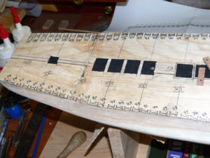

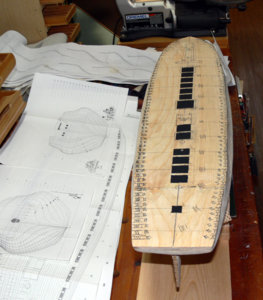

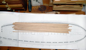

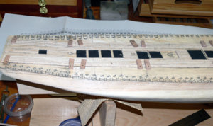

Good afternoon all, another beautiful day here in the back woods of Northern New Brunswick, Canada. I began the process of planking the lower deck today, slow but sure. I am using Maple planks, and find them quite a bit harder than the Basswood ones I usually use, but hope the colour difference will be worth it. Both should be correct for the scale and texture and colour of the vessel. I rub a soft pencil along the edge of the planks to simulate the tar of caulking and it usually serves.
I realize that my method of building is somewhat different from what the "experts" do, but I enjoy this method, and when you learn by yourself in oblivion with no access to a teacher or a mentor, just learning from what ever books are available, you make do. I am pleased with my finished products, so that is what is important.

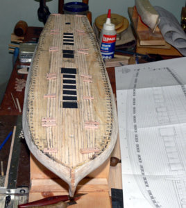

Making progress slowly on the deck planking. It makes me think about how difficult it would have been planking the deck on the real vessel. like my Great Grandfather did in his shipyard in Prince Edward Island, here in Canada. Now they didn't build ships as large as this one, just brigs, brigantines and schooners, but still the process is the same just a larger scale.planking continued.jpgplanking continued 2.jpgplanking continued 3.jpgprogress.jpg
