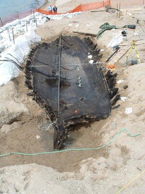

This is the story about the war of 1812 shipwreck the General Hunter where the wreck matches two historical accounts which support two different ships. So we have one shipwreck with a matrix glitch of two historical accounts.
The vessel itself, fashioned out of oak, would have originally measured about 54 feet long at the keel by 18 feet wide at midship, with two masts. Buried in the sand with it were a small cannon, four cannon balls meant for larger cannons, military buttons from the likes of the Royal Newfoundland Regiment, parts of a musket, a bayonet, an officer’s walking stick, a wooden deadeye used in the ship’s rigging, and pieces of a shoe. Spread among all that were 194 ceramic shards from plates, cups, saucers, soup bowls and a tankard, along with these artifacts was a small swivel gun lying next to the keel. Stripping the wreck of all the iron it seems odd a swivel gun would have been left behind. The artifacts discovered, and additional research at the U.S. National Archives in Washington, D.C., eventually told an epic saga of war and peace. Though outnumbered, the British had sailed with six ships, including General Hunter, to engage their nine American counterparts in September 1813, in a decisive battle for control of the lake. But the wind, which initially favored the British, started shifting almost as soon as the battle began, and after three hours of carnage, the Americans had won the day. General Hunter was now in U.S. hands, and while it’s unclear whether the ship saw further action, what is known is that after the war she served as a transport vessel, her name shortened to Hunter. According to documents that only came to light in 2005, Hunter was sailing from Michilimackinac to Detroit in 1816 when a violent storm on Lake Huron threw the ship off course. Fearing for their lives, the crew of eight opted to “put the helm hard a weather and run her in head foremost” toward the sandy beach of Southampton, according to the crew’s affidavit. Everyone on board survived, including two passengers. In an 1816 letter, a U.S. general reports that two boats were later sent to salvage what they could, then set the wreck on fire. Whatever remained was eventually submerged in sand for the better part of two centuries.
What we have here is the research and actual artifacts that identify the wreck on Southampton beach as the General Hunter. As a standalone research it is solid and supports the identity of the wreck as the General Hunter. History also documents another version of the same General Hunter which will be explored in this thread. The goal here is not to prove one General Hunter or disprove the other or if research was skewed to fit. I am calling it a glitch in research; it is left up to the reader to decide.

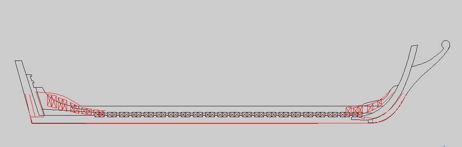

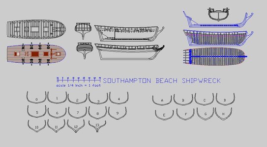

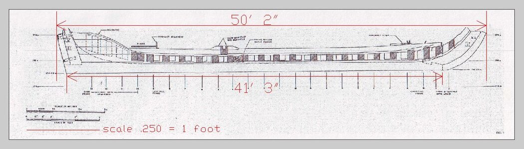

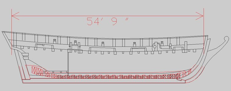

The starting point is a site drawing of the wreck. This was brought into CAD and scaled, once scaled measurements can be taken of the drawing
So far so good right?

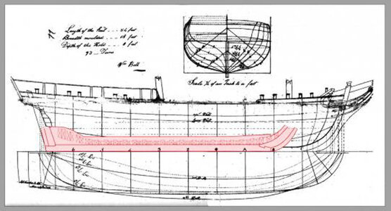

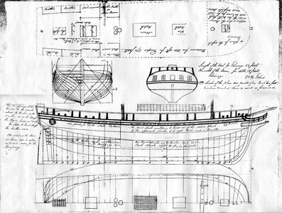

a glitch is there is a drawing of the General Hunter done by the builder William Bell in 1802ish so when the scaled wreck drawing is placed over the historic drawing there is a glaring problem, the two do not match.
This is where the research story begins and the question attempted to answer is WHY?
there is also another drawing done by John Stevens
This one does have a date of 1805 and it does say General Hunter and it has the builders name William Bell
This drawing is a contemporary drawing and is a tracing of the original one shown in the last post. There is one modification to this drawing and it is the cap rail which runs the length of the hull. The plan does state as a reference in the lower right corner of what the drawing is based on which happens to be the original drawing in post #1.

He just did not decide to use the original Bell drawing out of a whim, Even though there is no name on the drawing it was identified as the General Hope. William Bell was the Provincial Maritime master shipwright at the Amherstburg shipyard at Fort Malden. When Bell arrived at Amherstburg he built an unarmed transport named the General Hope. We can conclude the drawing is the General Hope because Bell did submit a drawing for a transport in 1803 and from correspondence the recommendation was made to close the bulwarks the lengh of the ship. That may or may not of actually been done, we will never know.
The General Hope was short lived and met with the untimely demise on Oct. 21 1805 when her captain James Fleet was drunk and ran the ship into a shoal the ship, the cargo and one crew member were lost.
William Bell was given orders to replace the General Hope and he built the General Hunter on the same plans as the Hope and launched the Hunter in 1807.
This is why John Stevens used the General Hope drawing for the General Hunter
going deeper we find John Stevens did a drawing of the General Hunter traced from the original drawing of the General Hope done by William Bell but not to stop there the General Hope drawing was traced from a plan drawn by Alexander Munn who drew a plan for a transport in 1802 or earlier.

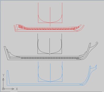

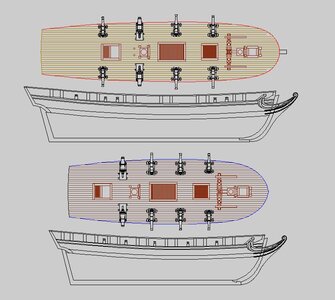

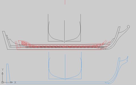

what we have here are CAD drawings (red) is the wreck (black) is the General Hope and (blue) is the Munn transport
taking Munn's transport and overlaying it on the General hope we see the length is the same, what is different is the angle of the stern post as far as the stem i am calling it close it is about the same shape and angle. Munn intended to have a figurehead and Bell's General Hope had a scroll.
Taking the wreck and over laying it on the General Hope WOW! it is not even close. This is a red flag historical data says the General Hunter was a copy of the General Hope.

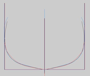

next taking the midship for each the wreck, General Hope and the Munn transport and laying them one on top the other and we have a match for all 3 same shape and deadrise of the floor.

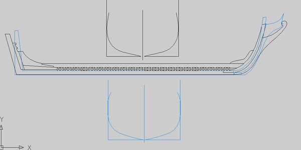

now watch this i took the wreck and cut it in half then moved the stem and stern out to line up with the General Hope. Oh my! i did not expect that the stern post angle and the stem are an exact match up.
The story can end here and we can jump to the conclusion that
in theroy this is what happened
Amherstburg around 1800 was a French settlement and the shipyard was not what we think as a shipyard where ships were built it was more of a shore side repair shop and landing point for supply ships. In February of 1799 it was reported by the commandant at Amherstburg carpenters at the boat yard were busy repairing the schooners Ottawa, Dunmore and the snow Chippawa. These repairs used up a greater part of the materials in the yard, especially the timber. By 1801 Fort Malden became an important base for the Provincial Marine ( the navy of Canada at the time), the deputy general at Quebec sent orders to Kingston naval yard to send to Amherstburg all carpenters judged worthy of employment. The carpenters were to build and repair small boats. William Bell now comes into the picture he was assigned foreman of the Amherstburg yard and instructed to build a transport to replace the Francis and Maria which had a combined tonage of 115. Bell submitted a drawing for a 90 ton transport which will become the General Hope. The problem faced by Bell was the lack of ship building timber at the yard, what was there was used up for repair work. Ship building timber was not as easy to obtain as you would think, The land around Amherstburg was privately owned and there was no open and free land to cut timber what land that was not owned by the people of Amherstburg was owned by native americans. It was at a great expense to purchase standing timber, cutiing it and hauling it to the ship yard because of the long distance and poor roads. When Bell was assigned as foreman he was given a one room cabin with a dirt floor and that was it, it was up to Bell to get the work done at the yard with little to no help from the navy.
As it were, lumber was obtained and the General Hope was built and launched. Then the unexpected happened after just one season or so the General hope was lost. Orders came down to replace the General Hope, holy #$%$% exclaimed William as he looked around the yard and saw no timber it was all used to build the General Hope. As if it wasn't hard and expensive enough he had to do it all over again. William took inventory of what he had on hand and what he needed then he figured it is not enough to build another 90 ton vessel so he opted to build a smaller version of the General Hope with what he had on hand and what he can get from contracting locals. This explains why the wreck and the General Hope plans match up at the stem and stern posts. Bell removed part of the mid section and shortened the hull. This practice was well known and used where ship hulls were lengthened or shortened by removing or adding to the mid section thus preserving the shape at the bow and stern.
Mystery solved the wreck of the General Hunter is a smaller version of the General Hope and all the historical accounts fall in line.

This is how i came up with the lengh of deck for the wreck. It was 54 feet 9 inches. going back to post #9 when i cut the wreck drawing and matched up the stem and stern post a perfect match. This time i went in the other direction and took the General Hope and cut it in the midship and brought the stem and stern post inward to match the length of the wreck. That is what you see here.

keel 41'3" length of deck 54'9" breadth 18' hold 8' tonnage? looking at the above list the wreck falls so neatly into the range of tonnage from 47 to 66, Facturing in ships built on the other lakes and averaging out the dimensions and tonnage the wreck is a vessel of 55 to 60 tonnage.
as you can see by the drawing everything is fitting a smaller version of the General Hope even the deadwood seems to fall within it's proper place. The stem and stern post match.

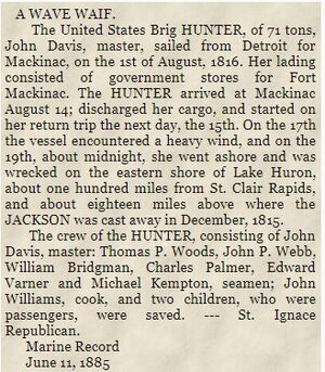

when the General Hunter was captured by the Americans it was towed to a harbor. Danniel Dobbins went to survey the captured ships and assess the damage. In his report he put the General Hunter at 73 tons just shy of the 80 ton shipyard record. Who is Danniel Dobbins and why believe his measurements? Dobbins was a ship captain and ship owner also a shipwright who starting building the Erie fleet before Noah Brown and Henry Eckford arrived to finish the job. If Dobbins recorded the General Hunter as a 73ish ton ship it probely was. The General Hunter was sold and registration records stated the Hunter at 71 tons. Going through newspaper articles of the time ships were published when they arrived and left port again the Hunter was mentioned as a 71 ton vessel.
how do you fit a 73ish ton vessel into a 60ish ton wreck? i don't know but something just does not add up.

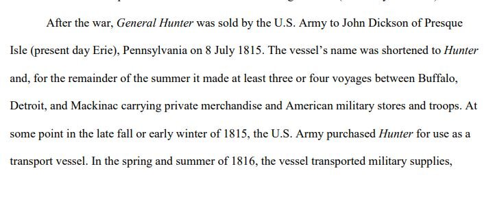

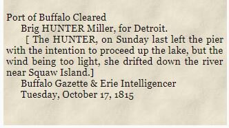

we know who bought the General Hunter and where he was from. The next step would be to take a trip to Erie PA and search the local arclives.

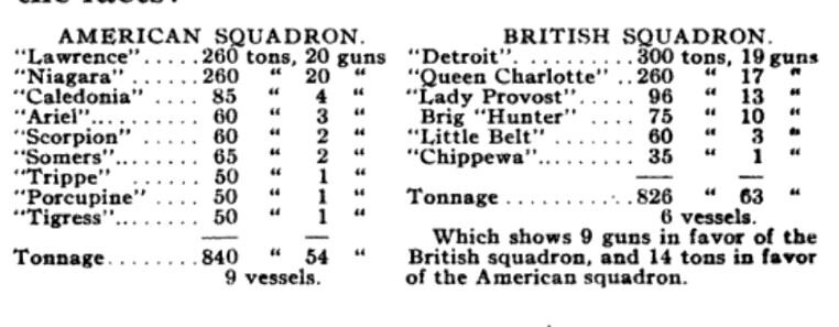

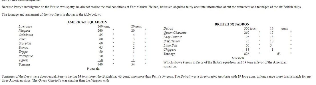

the offical naval listing of the ships i would have to make a trip to the National Archives or hire a resesrcher to find the original documents. The General Hunter is listed at 75 tons.

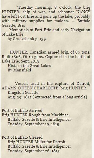

historical records the General hunter at 75 to 80 tons
